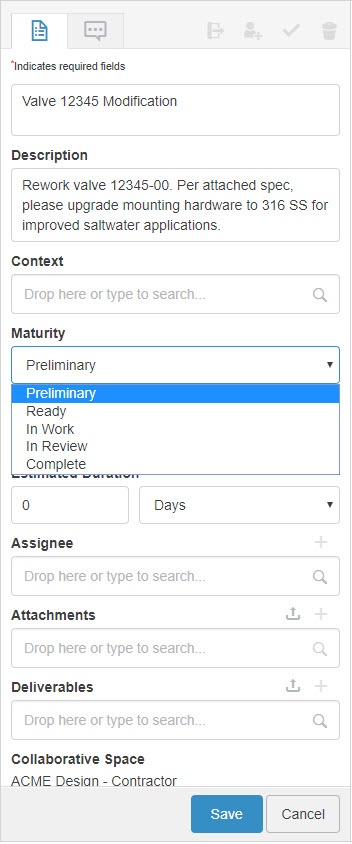

Simple task driven change - The foundational roles of the platform, namely Business & Industry Innovation, offer the majority of platform users the ability to create comprehensive task assignments for a designer or engineer to implement.
As you can see in the illustration, the initiator of the change can:
- Describe what needs to be done via a description
- Link any type of document on the platform as an attachment (generally used for specifications in the form of office documents, images, videos, etc.)
- Link deliverables to define what should be worked on
- Link context, if relevant, so the designer knows what higher design(s) are affected by the change
- Define the maturity of the task to track progress
- Track time estimation (not a popular field, but useful to those involved)
- Assign one or more users to the task so they will be notified as well as have the task included in their WIP list
Anyone associated to the change action (CA) can also create record comments which are attached to the CA and shared with the other reviewers and assignees.

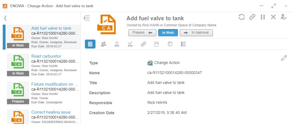

Change Management - The ideal tool for managing change on the platform via a Change Action. The CA allows you to fully audit what is modified as well as track the progress through assignees and reviewers that sign-off electronically on the work completed. The CA also can automatically create the new revisions of the design as well as release it once the reviewers have accepted the changes.
To coordinate multiple changes together, CAs can be combined under Change Orders (CO) to coordinate complex change activities. Dependencies can be created between the CAs to force completion in specific orders.
