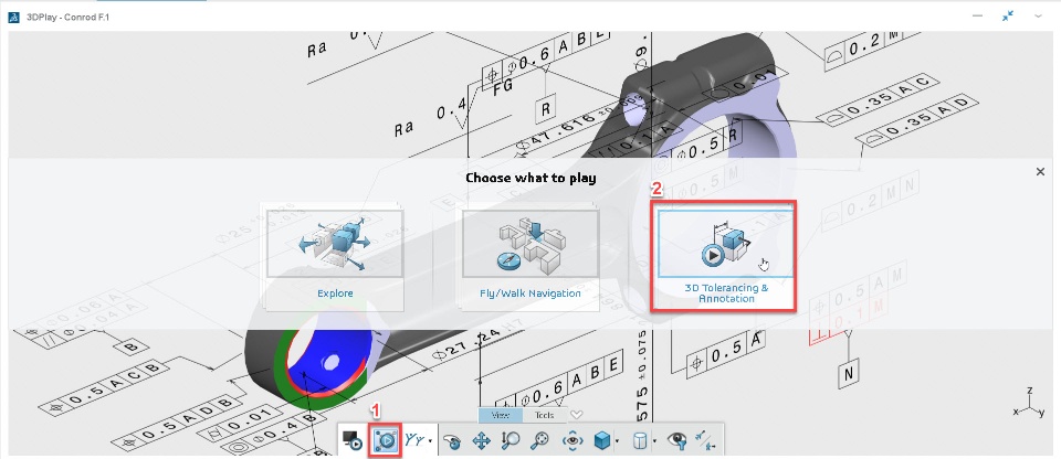

I'd like to introduce you to a very useful functionality for users who want to display the 3D Functional Tolerancing and Annotation (FT&A) contained in CATProducts or CATPart in dashboards.
In the 3DPlay for Dashboard, click (1) "Scenario Chooser" from the standard area of the action bar and select (2) "3D Tolerancing & Annotation". The user can select "Presentation Mode" to display the Tolerancing & Annotations in different views of the 3Dpart.

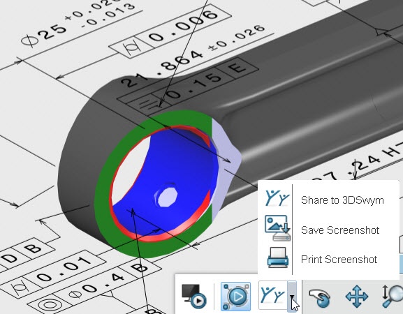

The views shown there can directly be captured and published to 3DSwym communities/conversations. The captures also can be saved or printed.
