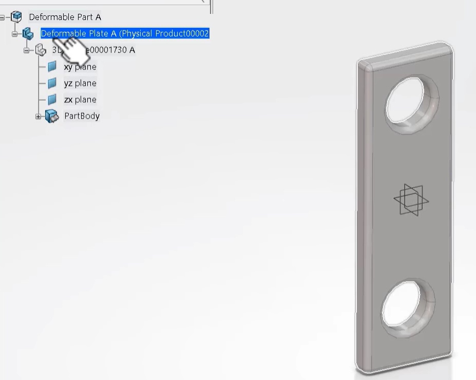

In CATIA, you can define a plate as a “Deformable” Item:

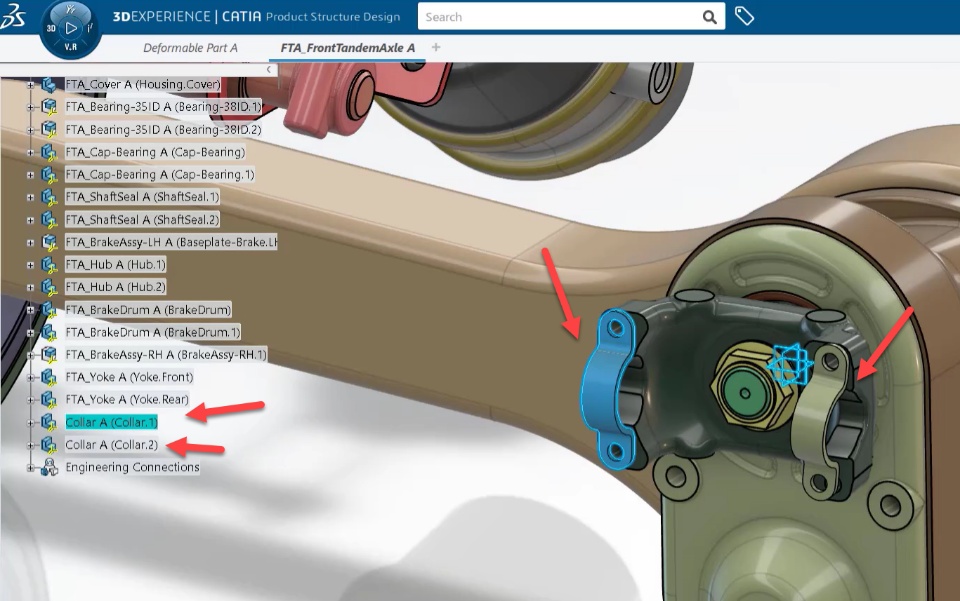

This plate can then be deformed, and as a result, two new “Deformed” instances are created and added to the assembly:
Collar.1
Collar.2

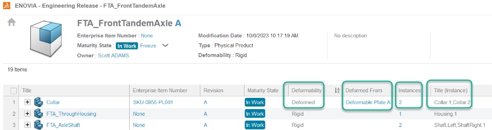

In Engineering Release, you can view this assembly as follows:
Summary of this example:
Engineering Item
Deformability
Deformed From
Deformable Plate
Deformable
Collar.1 (Instance)
Deformed
Deformable Plate
Collar.2 (Instance)
Deformed
Deformable Plate
