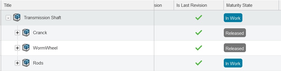

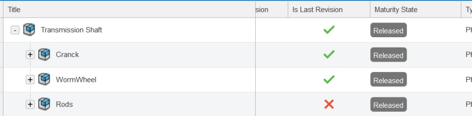

Major Changes on Released Engineering Item – Revise and Replace with Latest Revision:
Let’s assume you have an assembly that is completely released and a new revision of one child was created by a user. This new revision now needs to be linked to the parent, but since the parent is released, it must be revised and the new child revision needs to replace the existing one (which is not “Latest”).
 See this example – Product Structure Editor:

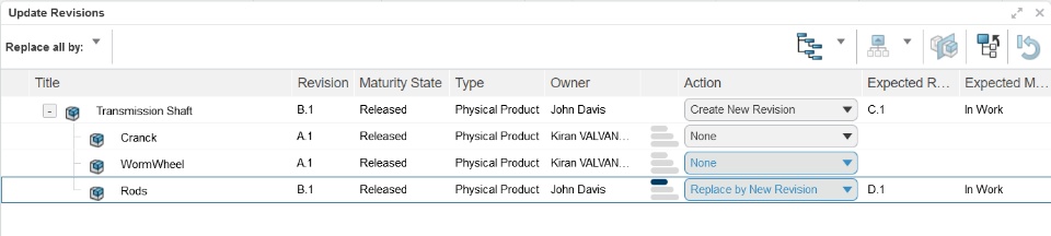

The easiest way to do all these actions in a single panel is to use the “Update Revisions“ command:
  • Select the parent (in Released state)
  • Run the command from the tool bar
The following panel allows you to make your decisions:
For the released parent, the action will be: Create New Revision
For the child that already has a later revision, the action will be: Replace by New Revision
The newly created assembly revision (In Work) will now include the latest child revision (also In Work):
