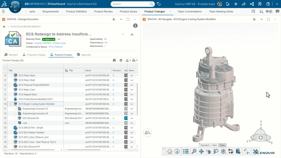

You can perform cross-highlighting between objects in the Proposed Changes or Realized Changes of a Change Action and 3D viewers such as 3DPlay, 3D Navigate, and 3DCompose.
This capability is especially useful when working with changes in the large, complex assemblies. It enables you to quickly locate and visualize an object that has been added to the Proposed Changes or Realized Changes directly within the 3D assembly, making change validation much more efficient.
How?
  1. Open the Realized Changes tab in the Change Action web app.
  2. Right-click the assembly and select "Open With" command. Open the assembly in any 3D viewer such as 3DPlay, 3D Navigate, or 3D Compose web app.
  3. Pin the opened app in the same tab as the Change Action app.
  4. Select an object in the Realized Changes to cross-highlight the corresponding object in the 3D viewer.
  5. You can also right-click the object and select the Focus command to automatically reframe the 3D view and center it on the selected object.
