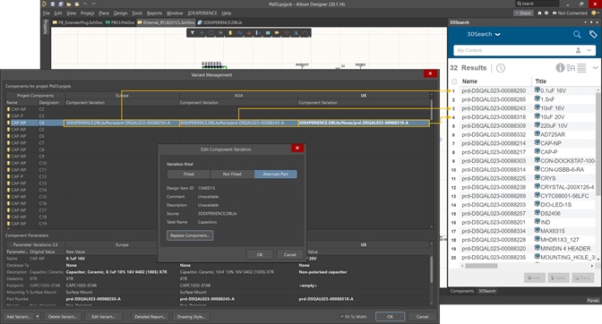

Beginning in R2021x FD03, Collaborative Designer for Altium allows users to assign alternate parts that are stored in 3DEXPERIENCE by maintaining a local component database (*.DBLib) that is synchronized with the parts in 3DEXPERIENCE (see an example in the image below). When the user saves the design to 3DEXPERIENCE, the design variants are saved as well. The local component database also allows users to choose 3DEXPERIENCE components while offline regardless if design variants are used.
