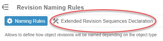

Extended Revision Sequences are configured in the Revision Naming Rules section of the Collaborative Spaces Configuration Center.

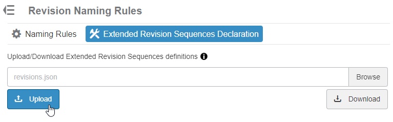

One or more extended revision sequences can be defined in a json file and uploaded to the platform. The json file of extended revision sequence definitions is uploaded in the Extended Revision Sequences Declaration tab.

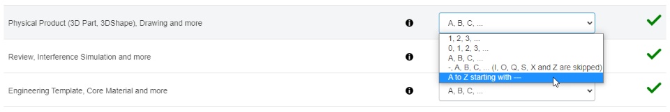

Once uploaded, your new extended revision sequences are displayed with the pre-defined revision sequences in the Naming Rules tab.

To delete extended revision sequences you just upload a json file with an empty list of revision sequences such as:
Note that you cannot remove an extended revision sequence that is used by one or more policies.
