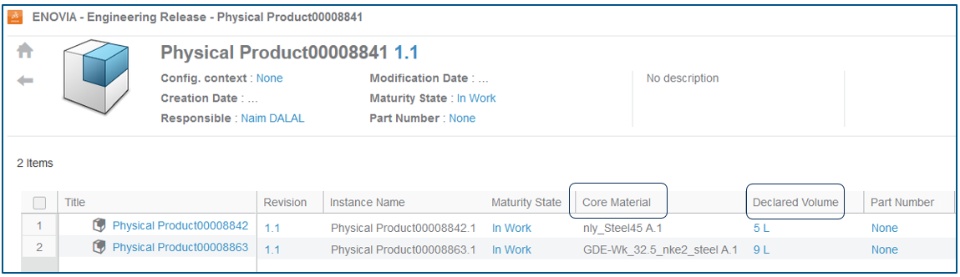

Once the Engineering Material definition is available in the platform, it can then be instantiated in the “Engineering Release” widget in order to create child-engineering items that represent the consumption of a specific quantity of these materials (as “New volume of material”).
During this definition, the quantity per material must be defined. Currently, the definition is limited to “volume” type as a unit of measure:
  • Liter (L)
  • Deciliter (dL)
  • Centiliter (cL)
  • Milliliter (mL)
Once the unit is selected, a new engineering item is created with values in the following attributes:
  • Core Material
  • Declared Volume
Note:
  • All other engineering items that do not represent materials, will have empty values in these attributes
  • All engineering items (whether they represent the volume consumption or not) will have the same type: “Physical Product

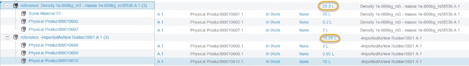

Calculating the total material quantity required for an engineering item:
The total material quantity is available using the “Group by Reference” option in the widget, which will calculate the total “Declared Volume” in a single unit: L (no matter the unit defined for each declared volume: L, dL, cL, mL), allowing product engineers to have a consolidated view of the global quantity of the material consumed in an engineering item.
