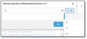

The following units are available for the materials definition:
L (Liter), dL (Deciliter), cL (Centiliter), mL (Milliliter)
(Currently only volume units are supported)
How to consume a volume of Core Material?

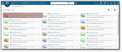

Use the option “New volume of material” from the root Engineering Item. This option will open the search function whereby users can search the relevant Core Material to add.
Once the material is selected, you will be prompted to define a quantity and unit for the selected Core Material:

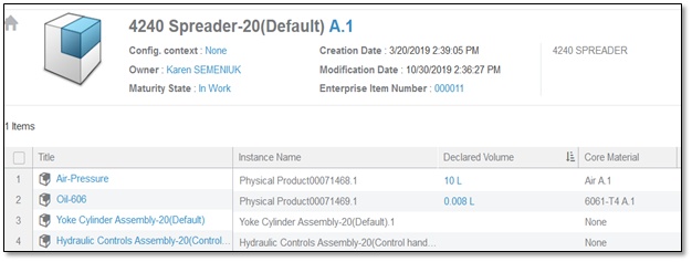

A new Engineering Item is then created and linked to the root Item. This new Item has two material attributes: Declared Volume, Core Material.
To modify the “Declared Volume” of the Core Material, you can:
- Either select the “Usage view” in the Datagrid view that displays all the Core Material consumptions and the quantity of each
Or
- Select the “Reference view” in the Datagrid view that groups together the instances of each Core Material and lists the total quantity of each Core Material.
Clicking on the “Quantity” enables modifying it.

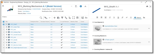

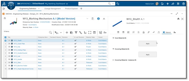

Core Material - as the material of which the Engineering Item is made of
This is only a description of the materials that the Engineering Item is made of - such as wood, steel and, zinc. No new items are created in this definition.
This Core Material is applied on the Reference of the Engineering Item.
When you define a Core Material as such, the material will be displayed in the widget like this:
The Usage View | The Reference View | |
Core Material as a material of which the Engineering Item is made of No new Engineering Item is created | Shows the Core Material (in both: the grid and the right side panel) | Shows the Core Material (in both: the grid and the right side panel) |
How to apply a Core Material on an Engineering Item

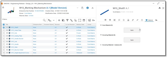

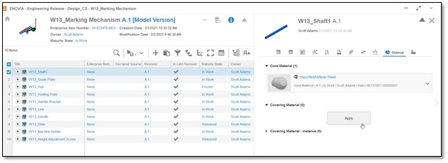

Select the Engineering Item you wish to define Core Materials for, and then click on the “Material” tab.
Next, use the “Apply” button to add new Core Materials.
Existing materials can be removed or replaced by other material if needed.
Covering Material
The target of this definition is to describe the material that covers the surface of the Engineering Item.
The Covering Material is available on either the Reference or the Instance of the Engineering Item.

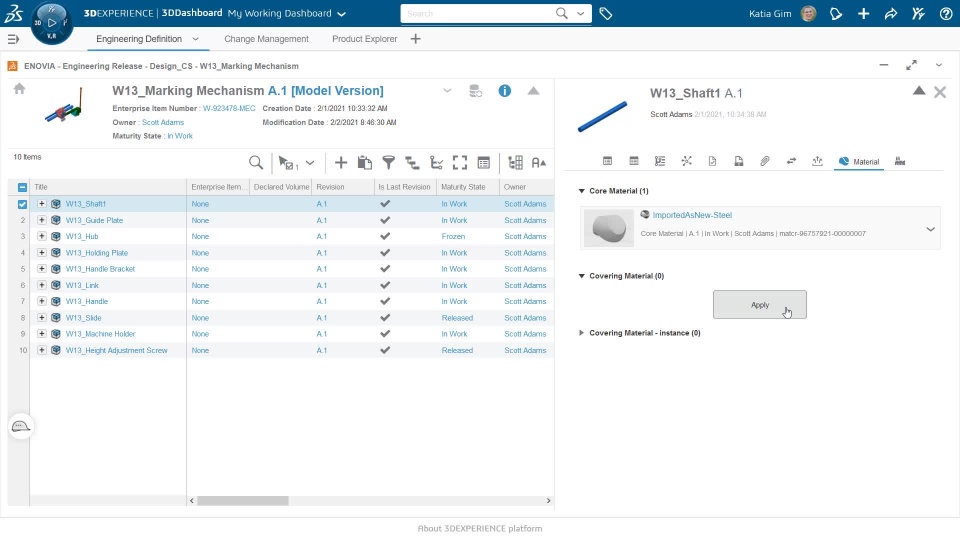

How to apply a Covering Material on an Engineering Item?
Covering Material is defined in a similar way as Core Material: apply the material found in the search results:
Note:
The functionality to apply Covering Material on Instances is only available in 3DEXPERIENCE CATIA and not in the “Engineering Release” widget; this definition will then be displayed in the widget.
The attached video illustrates this process in detail.
