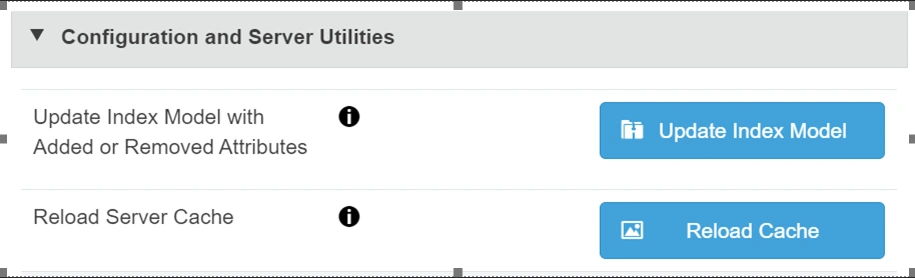

We did run Classification indexing.

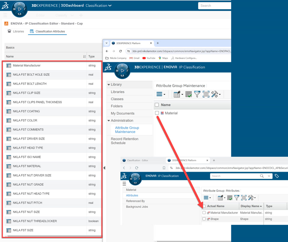

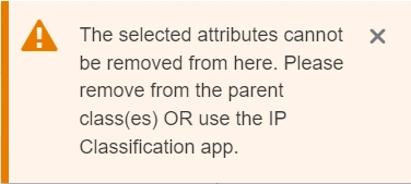

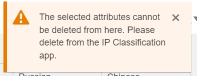

Additionally, in 3DSpace we have one attribute group containing 2 attributes but in 3DDashboard I still see the attributes created in 3DSpace that I deleted.
If I try to delete these, I get the following message, but they don’t exist in 3DSpace as clearly shown.

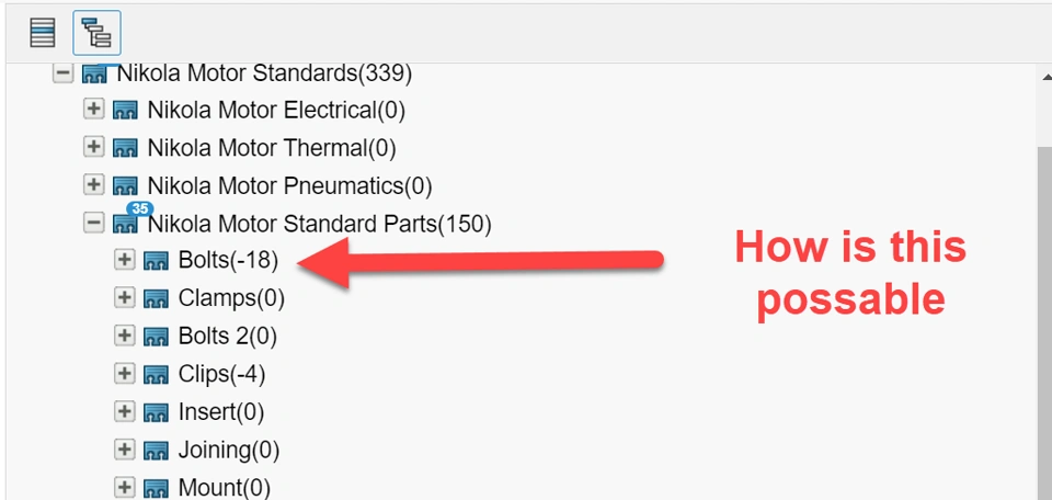

Why does the Classification count show a negative number?

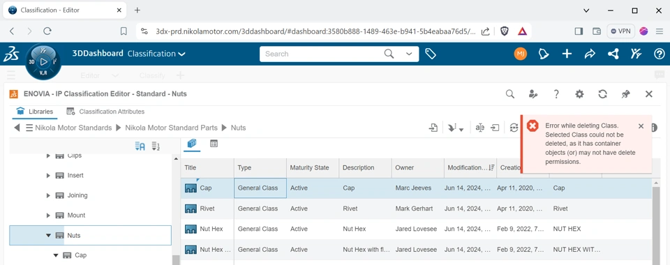

Notice how “Cap” thinks there is a Classified Item (1) but notice that there are no attribute groups, classified items, or sub classes, and the only relation is the parental classification folder (class).
There should be no reason why I can’t delete this Classification Folder (Class), since I own it.
