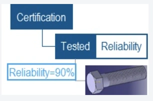

  • Non-Essential Attributes:
An attribute is non-essential when it helps to describe the object.
A non-essential attribute has no direct impact on the definition of the object.
Its value can vary over time without affecting the definition of the object itself.
The object can be fully defined, released and not modifiable anymore, yet, you can still add some information to it with non-essential attributes.
Example:
A screw can be declared with a reliability of 90% when it is bought from a supplier, however, after a while, the reliability can be set down to 80% because of some crash tests. It is yet the same screw.
