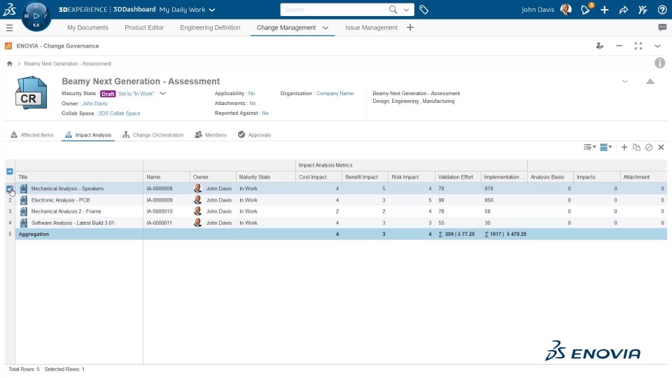

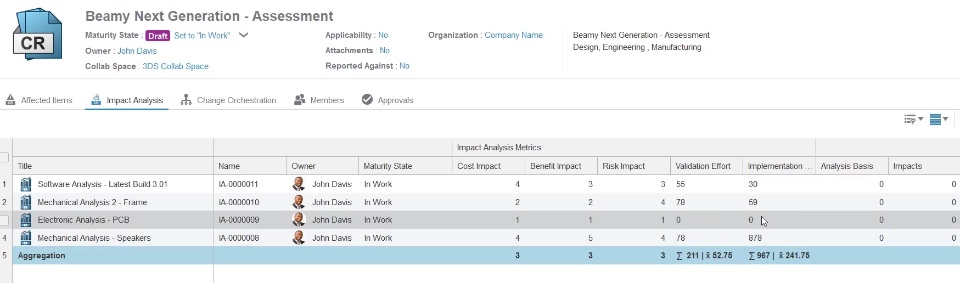

Impact Analysis:
Using the Impact Analysis tool, the functional teams can easily provide detailed information related to the effort, costs, risks and other essential parameters that help reveal the potential impact of the proposed change. Aggregated values are displayed to give the user the overall impact from all aspects:
Note:
Impact analysis can be duplicated to ease the creation process of similar impacts.

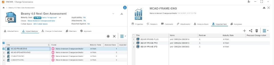

Impacted Items:
The functional teams investigate the impact and effort for their organization. Possible impacted items are added to the Change Request, to help understand what items could possibly be impacted by the change. This will also provide functional leads the ability to navigate the affected items to easily identify their impact across other organization functions (manufacturing, engineering etc.).
Relations:
Using the “Relations” tool, the functional leads can navigate the affected items to easily identify their impact across other organization functions (manufacturing, engineering etc.)
Note:
The same tool “Relations” is also available from the Change Action.
