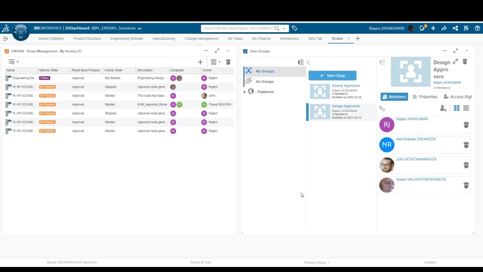

Want to learn more about using Routes and User Groups with Change Actions? Watch the two video demos below...
The first video shows how to create a User Group using the new widget (R2021x On Cloud) and assign the new User Group to the Route. Once the Route is ready and active, we can use this in a stand-alone Change Action.
The second video shows the use of the Route with the User Group in a Change Action. Here, instead of searching for the users, we can select users from the User Group. This is a much faster and shorter list to browse. We also can have different User Groups created and assigned to the route.
