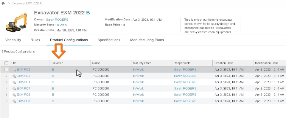

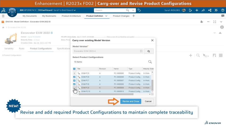

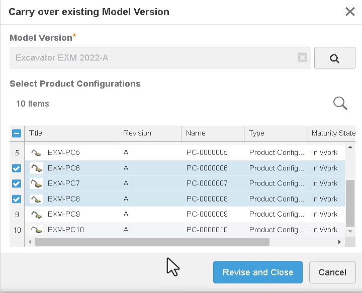

Starting from the R2023x FD02 release, you can now carry-over (Copy + Revise) Product Configurations from old a Model Version (A) to the evolved Model Version (B, C...) to improve productivity while maintaining complete traceability. For this, the "Carry over...” option is provided in the Model Version’s ID Card menu. This option allows you to search and select the existing model version and then displays the list of existing product configurations in it. You can select the required Product Configurations from the list and click "Revise and Close" option.
The new revision of these Product Configurations is created in the target model version. You can then reuse these Product Configurations or update them as required.
The value of Name attribute remains the same for source and new Product Configurations. The revisioning is useful in identifying the source of a product configuration with complete traceability.
Note: You can only carry over Product Configurations that are in the Frozen, In Work, or Private maturity state.
