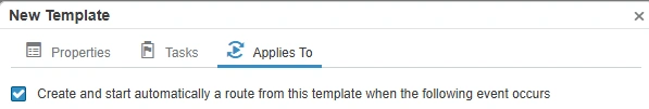

In R2025xFD01, we introduced a new 'Applies To' tab for Route Templates, enabling you to define rules for automatically creating routes based on the template.
  1. Enable Automatic Route Creation
    Select the 'Create and start automatically a route from this template when the following event occurs' checkbox.

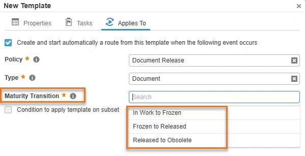

2. Define the Criteria

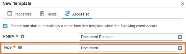

Policy:
Choose the governing policy for which the rule is being created.
For documents, select 'Document Release' as the policy
Type:
Specify the object type governed by the selected policy.
The available object types depend on the selected policy.
For documents, select 'Document' as the type.
Maturity Transition:
Select the maturity transition that triggers the route creation.
The route is created between the chosen maturity states.
The available transitions depend on the selected policy.
For documents, the following transitions are available:
In Work → Frozen
Frozen → Released
Released → Obsolete

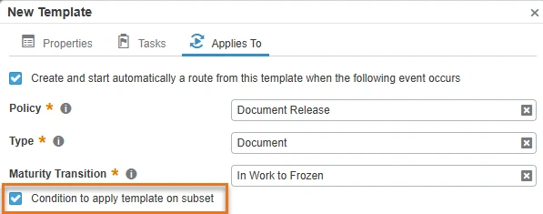

3. Apply Additional Conditions (Optional)
To further refine the target documents for route creation, select the 'Condition to apply template on subset' checkbox.

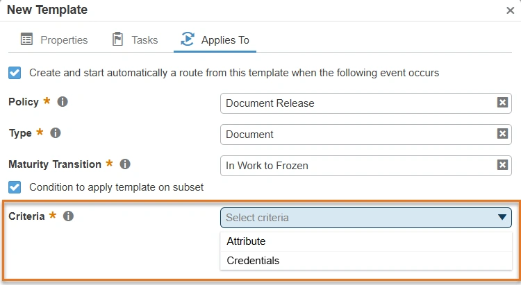

Criteria:
Choose the criteria for defining the condition:
-  Attribute
- Credentials

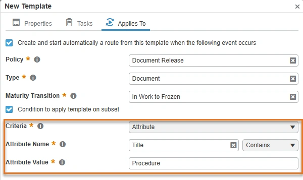

If 'Attribute' is selected as the criteria, specify the Attribute Name, choose the appropriate operator, and provide the Attribute Value.
Note: Currently, the 'Title' attribute is the only available attribute out of the box.

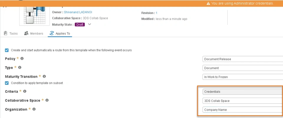

If 'Credentials' is selected as the criteria, the Platform Administrator can specify the Collaborative Space and Organization.
In this case, the Route Template will apply only if the specified Collaborative Space and Organization match those of the document.
Important Note: As a Leader, you can define the 'Apply To' setting, but you cannot specify the Collaborative Space and Organization for the Credential criteria.
Only the Platform Administrator has the authority to set these parameters.

The Platform Administrator receives a request notification to release the Route Template to make it available for use.
As a result, a ‘Require Route for Maturity Change’ rule is automatically added in the
‘Collaborative Spaces Configuration Center’ → ‘Maturity Graph’, based on the parameters specified
in the ‘Applies To’ tab.

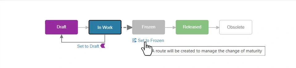

Once the configuration is complete and the template is released, a route will automatically be generated whenever a user triggers the selected maturity change for a document that meets the defined criteria.
As a result, the document’s lifecycle will be controlled by the route, preventing manual promotion of its maturity state.
