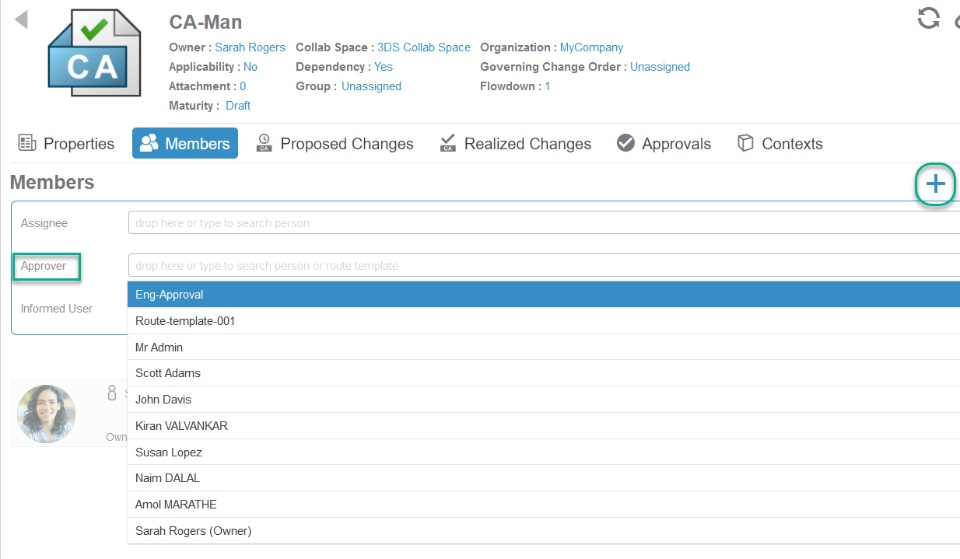

You can add "approvers" in the following ways:
  • Individual users
  • A list of users using a Route Template (using single person or groups)

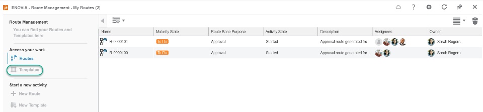

Route Template:
  • To enable the use of an approver route that contains various approver names, you must define a Route Template, activate it and then use it in the list.
(See the example in the image above ("Eng-Approval" route template))
Then, users in this route template are assigned as approvers in the Change Action.
Note:
The “Route Base Purpose” of the Route Template should be "Approval."
(See following image)

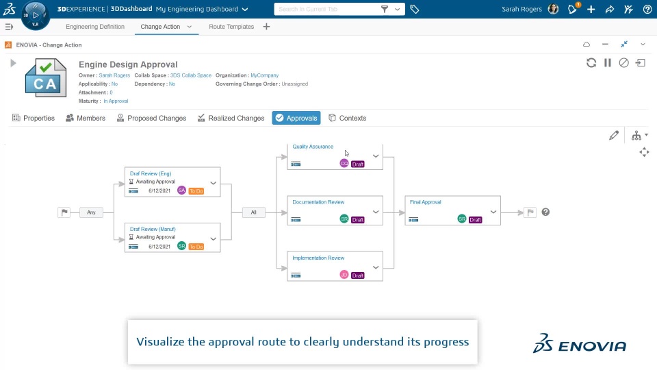

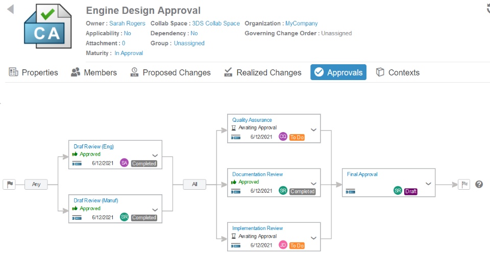

The route task flow can be displayed in a grid or a graph view:

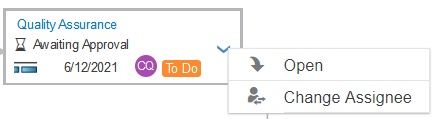

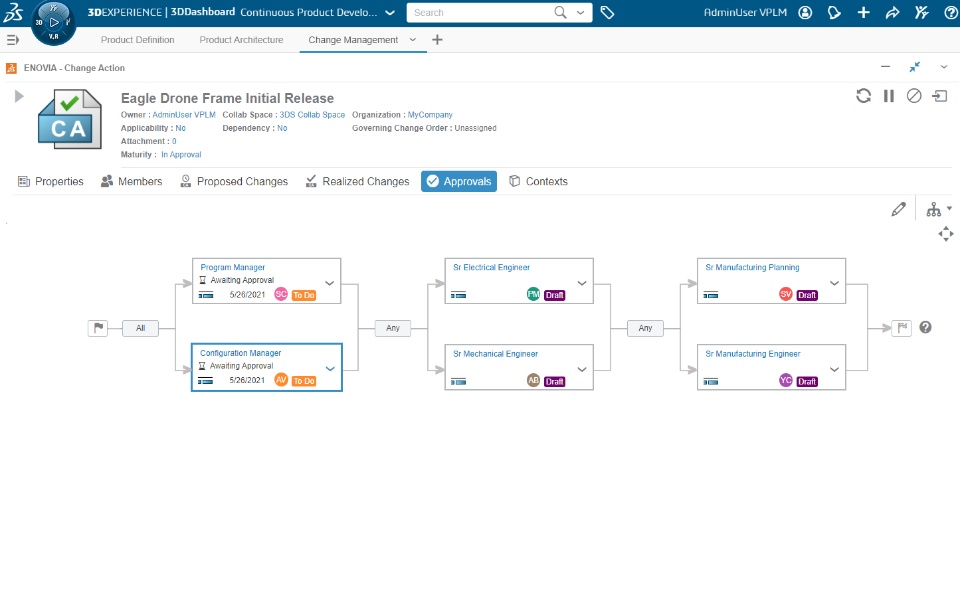

New tab “Approvals” in the Change Action:
A new tab in the Change Action displays the route tasks flow when the Change Action is in “In Approval” state:
This route view improves the approval process experience by allowing approvers to graphically visualize the tasks and their status. Moreover, the approvers can open the task and approve/reject directly from this view.
