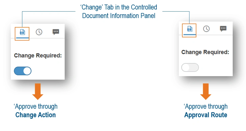

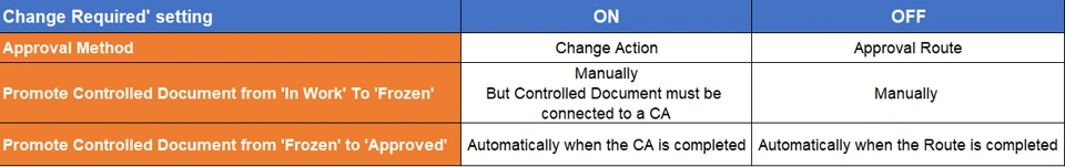

Before R2025xFD04 release, the approval method was strictly tied to the ‘Change Required’ setting. This setting is available in the 'Change' tab of the Controlled Document’s 'Information Panel':
Based on this setting, the relevant method could then be selected, as follows:
Since R2025xFD04 release, the approval method no longer relies on the ‘Change Required’ setting. You can choose any method you like, and when you add a Controlled Document to a Change Action, the setting is automatically switched ON.

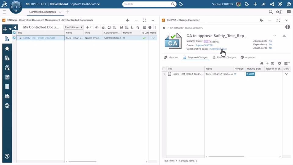

The following video illustrates the approval process using a Change Action:

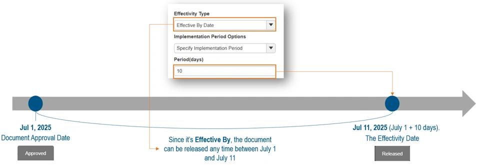

The release timing is controlled by the Effectivity Date setting.
This setting is available in the 'Document Effectivity' tab of the Controlled Document’s Information Panel. it is defined by two key elements:
Effectivity Type:
- Effective On Date means the document becomes effective starting from the specified date —not earlier.
- Effective By Date offers more flexibility: The document may become effective on the specified date or earlier.
- Implementation Period options: determine when the effectivity date will occur:
- Manually set a specific date, or
- Define a number of days after approval
The following examples illustrate how the Effectivity Date is calculated:
Example#1:
- The Approval Date is July 1st - this is the date when the Controlled Document was promoted to the 'Approved' state.
- The Effectivity Date is July 14th - according to the setting
Because the Effectivity Type is Effective On, the document can be released on July 14th and not earlier.
Example#2:
- The Effectivity Date is July 11th - which is 10 days after the approval date (according to the setting)
Since the Effectivity type is Effective By, the document can be released any time between July 1st (the approval date) and July 11th (the Effectivity Date)

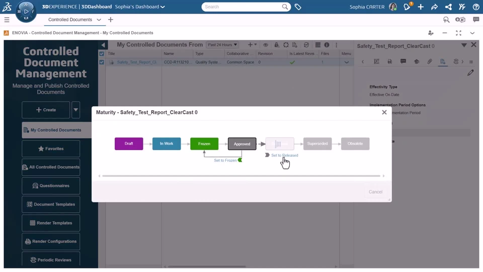

The following video illustrates how to set the Effectivity date and Release the Controlled Document:
