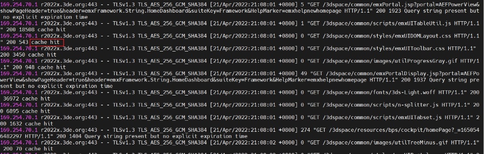

Add %{cache-status}e to your log format of your VirtualHost, below is an example.
LogFormat "%h %v:%{local}p %l %u %{SSL_PROTOCOL}x %{SSL_CIPHER}x %t %{ms}T \\"%r\\" %>s %b %{cache-status}e" 3deformat
CustomLog "|/usr/DassaultSystemes/apache/bin/rotatelogs logs/3de_access-%Y-%m-%d.log 86400" 3deformat
1. Clear browser cache, access 3dspace.
2. Check apache access log, in the end of line , you find "cache hit" or other status.
"cache hit" means apache cache is working.

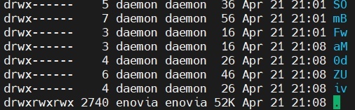

Another way is to check the disk cache files.
1. Clear browser cache, access 3DSpace.
2. Go to CacheRoot, here it is /tmp/DassaultSystemes/3DSwym/cache/httpd
ls -altrh
You can find the files created when accessing the 3DSpace.
This means disk cache working also.
