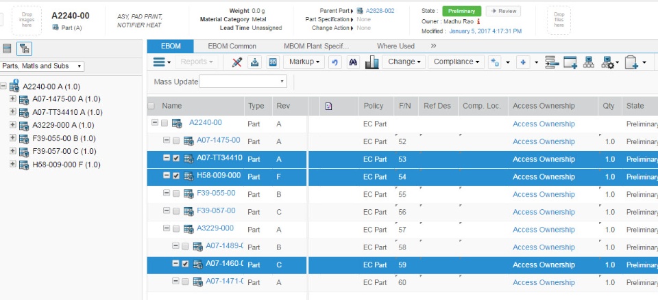

New I have selected the following three parts to be shared with suppliers. Note that the parts can be at any level in the EBOM.

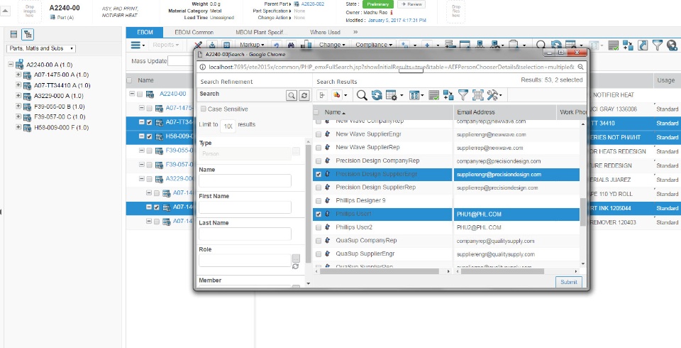

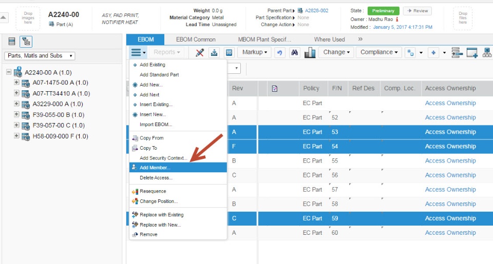

You can now add the users by the command  “Add Member”.  You can either select a person, or a security context here. You can also select multiple suppliers with whom you want to share these three parts.

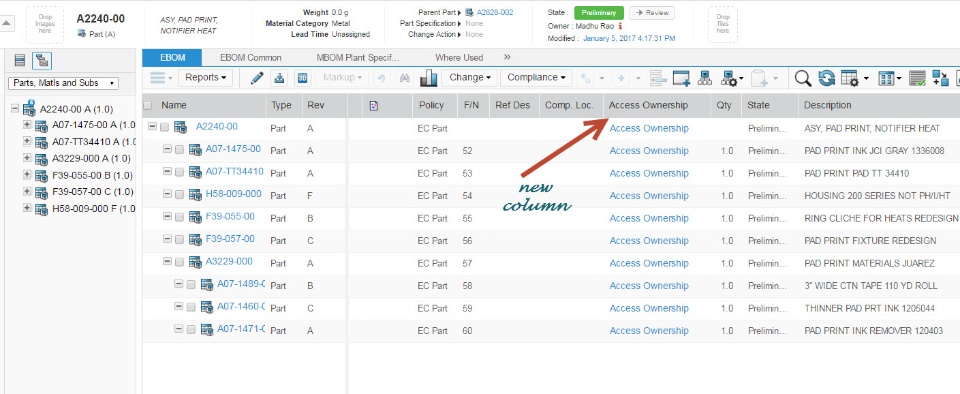

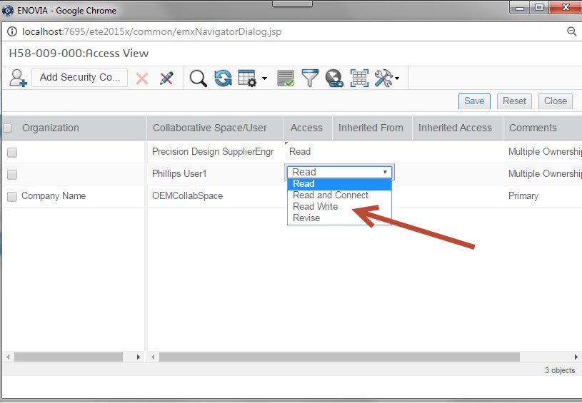

By default, all the users selected here will have ‘Read Only’ access. It can be individually modified for specific users by selecting the ‘Access Ownership’ column and changing the access rights as shown below.

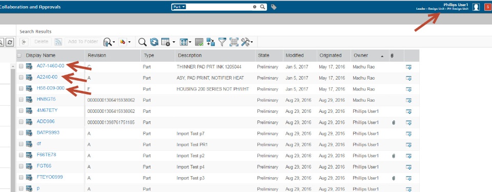

Now, I have logged in as a supplier user, and can see the parts that I am allowed to see.
