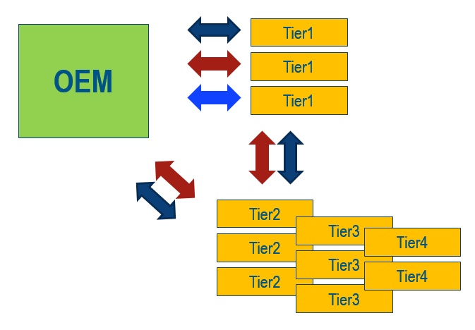

Communications between manufacturer running 3DEXPERIENCE and Suppliers introduces numerous challenges. There are challenges at the development level in different design practices and development processes which slow information exchanges. Managing many suppliers increases the complexity to coordinate work and share the right information between the various stakeholders efficiently. Movement of data that makes up the IP underlies these challenges. Handling of the data is affected by three types of interaction between the supplier and the manufacturer.

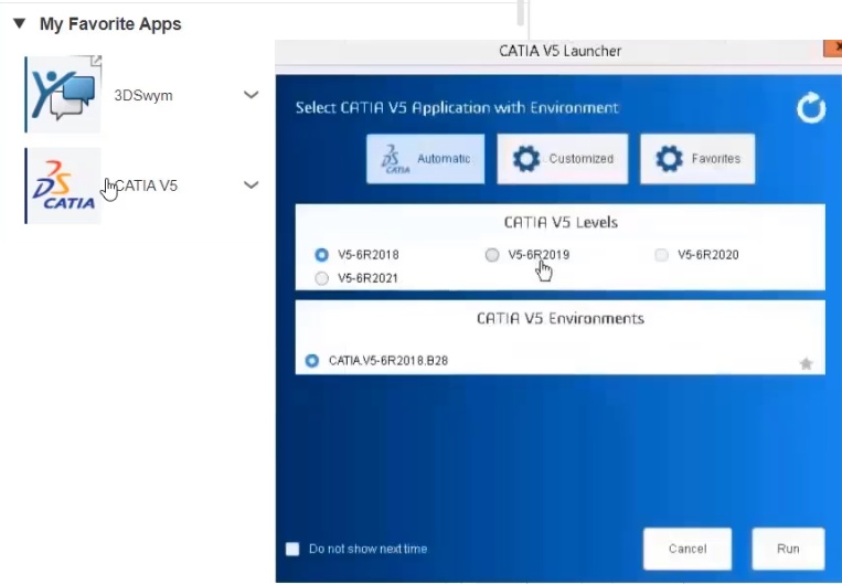

3DEXPERIENCE platforms assist suppliers using CATIA V5 by managing the CATIA V5 version data that was created when starting a particular design session.

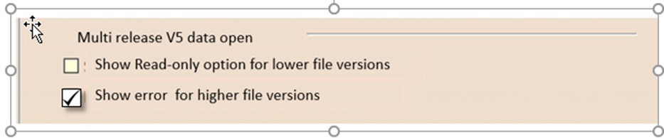

3DEXPERIENCE platforms are also sensitive to scenarios where the data from one version of CATIA V5 is opened in a different version and combined such that a mixed version structure is created. These use-cases are managed by persistent settings on the system that monitor the activities of users and notify them if the data integrity may be compromised.
