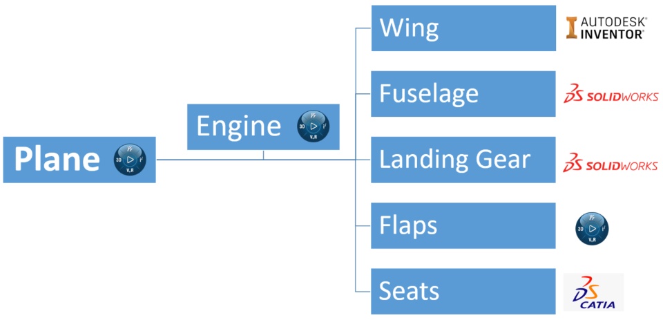

In the following example, the OEM works in a hybrid environment. 3DEXPERIENCE CATIA manages the structure of the product and most subassemblies are created using CATIA V5, SOLIDWORKS and Autodesk® Inventor®.
Let us consider interaction with four suppliers – each with a single CAD environment using SOLIDWORKS, CATIA V5, CATIA 3DEXPERIENCE and Solid Edge® respectively. The interaction itself, generally takes two forms:

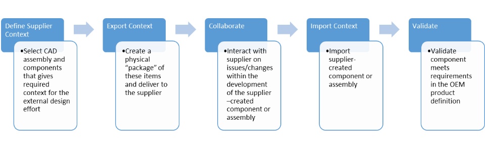

I will focus on the latter approach where the movement of data between the two parties is limited to importing and exporting content between the OEM and supplier. Here, there is no interaction between the development processes or business models of the two companies.
The following process shows the basic steps within the overall exchange process that are pertinent to the exchange of data …

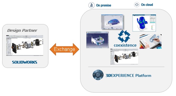

SOLIDWORKS
  • Within the Collaborative Designer for SOLIDWORKS role, you can create “data exchange packages” using Import and Export commands. Data exchange commands are available in the Tools tab of the MySession window of the CAD session. Here, you can create a data exchange package from a SOLIDWORKS assembly or from a SOLIDWORKS part saved to the 3DEXPERIENCE platform. A supplier can modify any CAD files that have an editable status. For assemblies, you can add and remove components. The import commands reference and prompt you to add required references to the package when the OEM attempts to import the modified package. These tools also offer extended abilities beyond the simple exchange scenario that we are discussing here for migration and coexistence scenarios.
