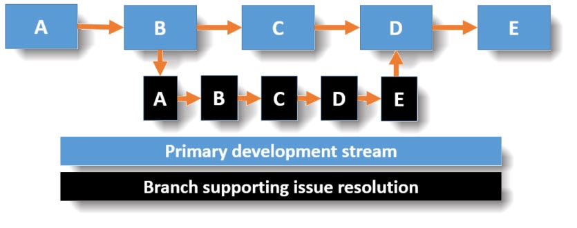

1. A flaw in the current design revision that cannot be corrected in the current development and must be addressed after a future revision

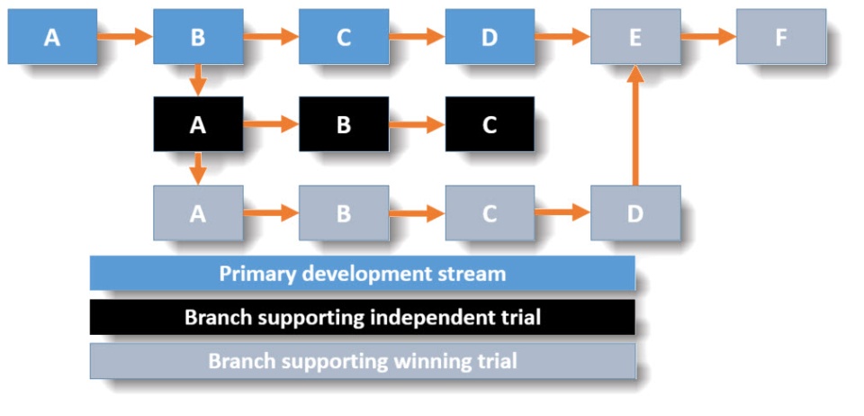

2. A design trial to explore design alternatives in parallel to the current development

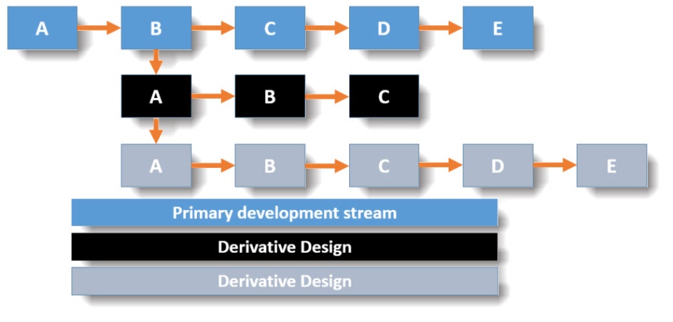

3. A means of maintaining multiple independent configurations of a design with independent evolution lifecycles.
4. Development of product derivatives that do not affect the original product

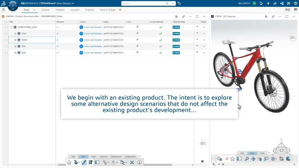

Branching on the 3DEXPERIENCE platform is available with the 3D Product Architect, Product Release Engineer, and the Collaborative Lifecycle application. Let’s see how to create branches in a structure using the Product Structure Editor...
