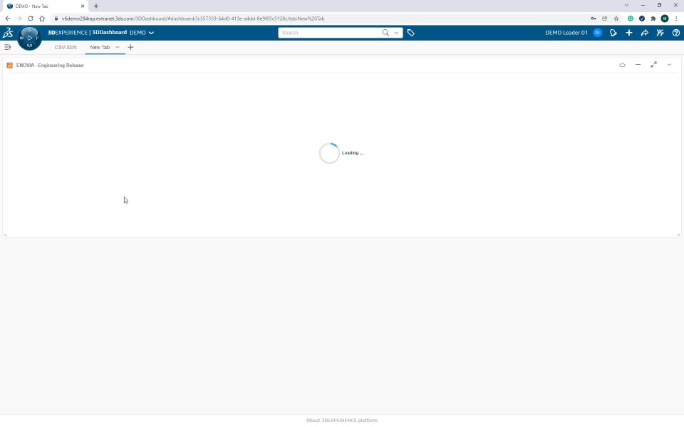

Drag & Drop Widget to another Tab
You can move your widget to another tab with Drag & Drop operation. Even if you have not tab to move at the beginning of the operation, you can create a new tab during the Drag & Drop operation.

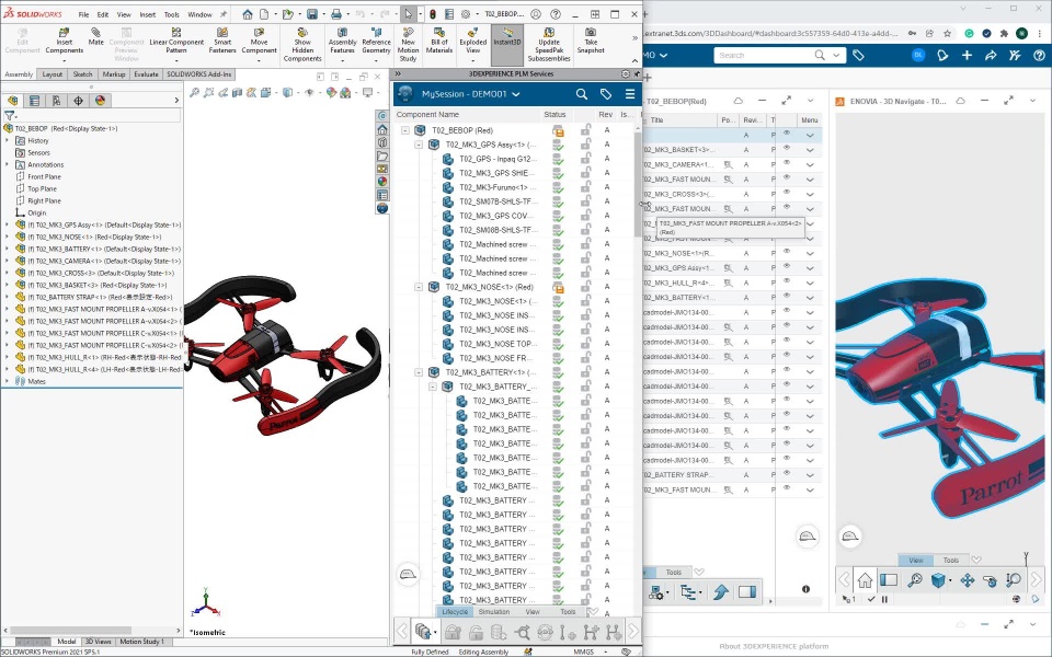

Drag & Drop between Browser and SOLIDWORKS
This functionality might save your time to search objects on your web browser or SOLIDWORKS. You can directly drag & drop Engineering Items from a widget to SOLIDWORKS or the opposite direction.

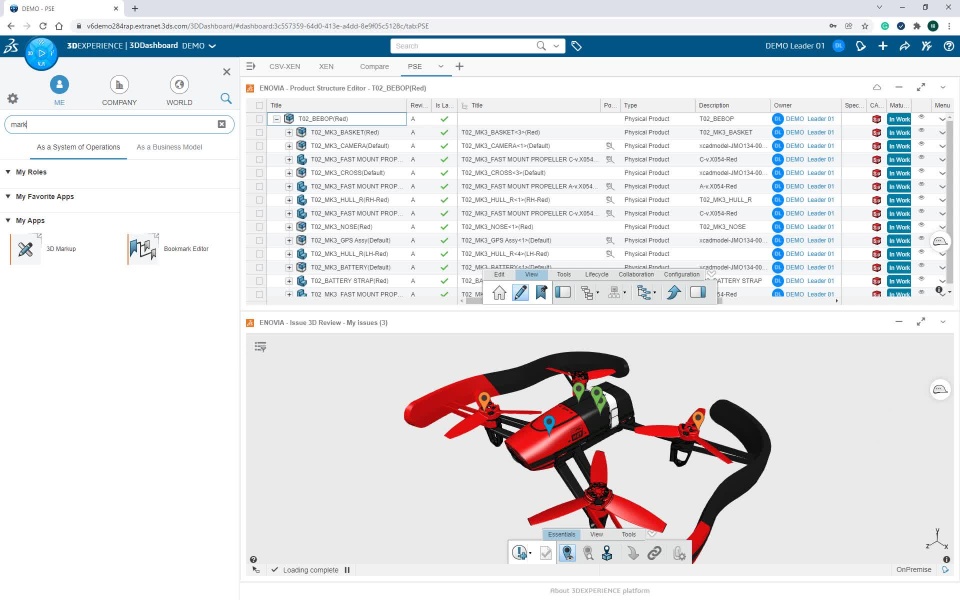

Transition to/from the other Widgets
You don't need to look around some widgets thanks to this functionality. You can change your 3D viewer part of Product Structure Editor to Issue 3D Review or 3D Markup from 3D Compose. This function is only available on Product Structure Editor (PAU), not available on Product Structure Explorer (CSV).

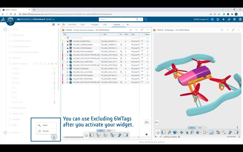

Excluding 6WTags
I know you know about how to use 6WTags. It's mainly used for filtering your search result or items on your widget. But do you know it can be used for filtering out Engineering Items which have tags you specify? The function is available on both Product Structure Explorer & Editor.

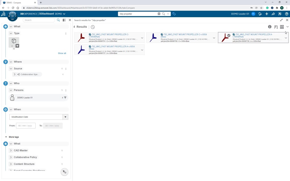

Compare 3-5 Items
This function is a little bit old one so you have not seen it on recent what's new for example. The Compare widget is mainly used for comparing structures but it can be used to compare 3 to 5 single items on it.
