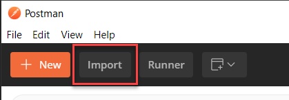

From the top toolbar select Import

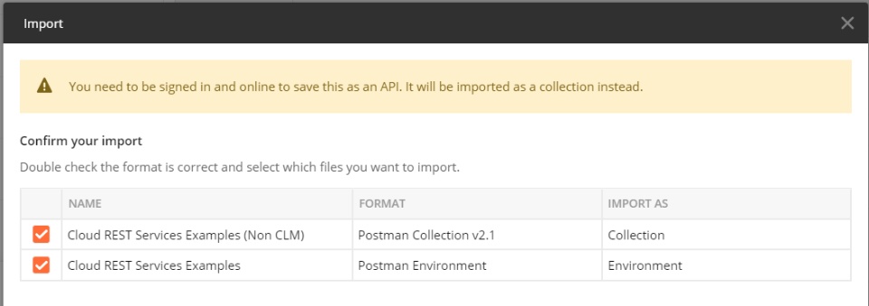

Drag and Drop template file (Cloud REST Services Examples (Non CLM).postman_collection.json) and environment file (Cloud REST Services Examples.postman_environment.json) into dialog
Click Import

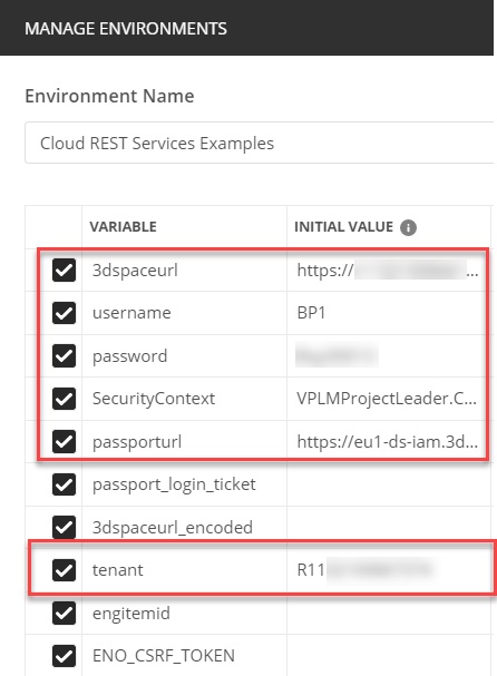

Set environment from pulldown and setup variables used.  Only those highlighted are required as the others will be set via the Postman requests programmatically.  The tenant is optional and only required if connecting to a cloud environment.
