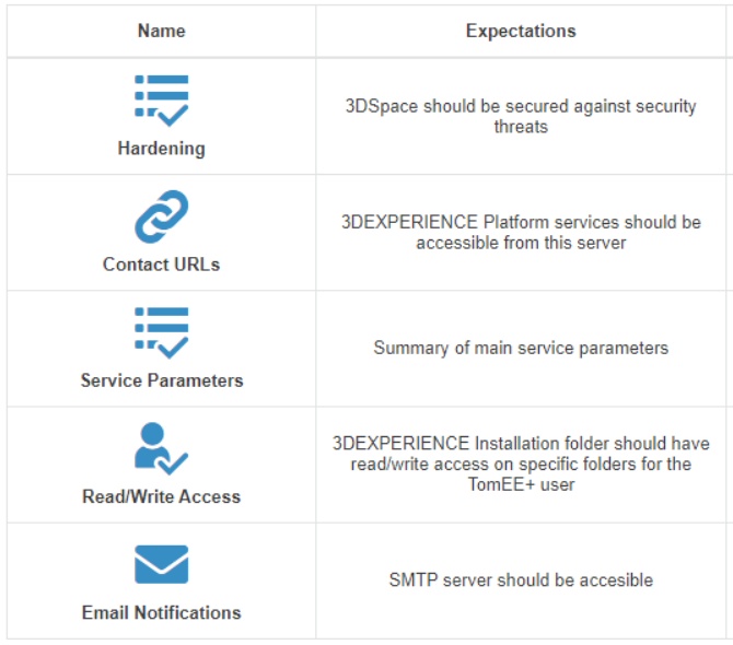

Were you aware the 3DEXPERIENCE platform comes with a tool to check the integrity of the installation?
This diagnostic tool checks that the 3DEXPERIENCE platform and its mandatory services are up and running as expected following your installation and deployment.
It is designed to be run on a new installation, before any functional tests have been executed. It creates a report with results for the following areas:
This tool is available with 19x FD07 and higher, 20x FD01 and higher, and 21x GA and higher.
