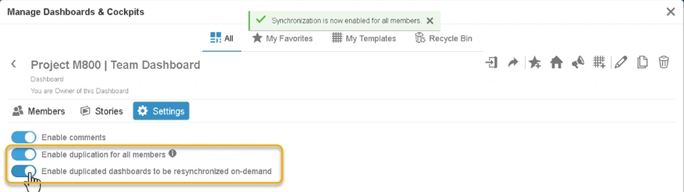

Starting from the R2024x FD04 release, the members added as the “Contributor” or “Reader” of the dashboard can now synchronize the duplicated dashboard with the source dashboard. To enable this, the "Owner" of the source dashboard must select following two checkboxes in the “Manage Dashboard & Cockpits” dialog box:
  • Enable Duplication for All Members
  • Enable Duplicated Dashboards to Be Resynchronized On-Demand

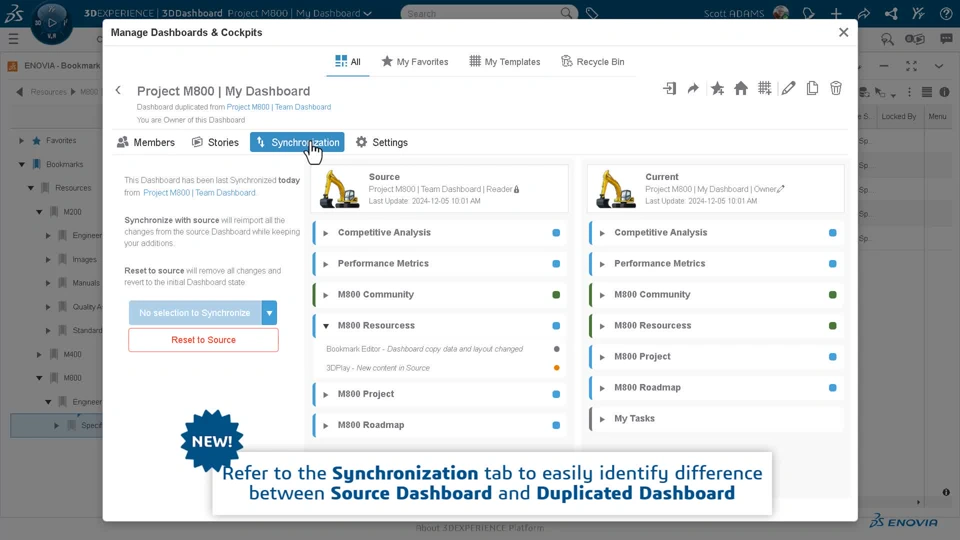

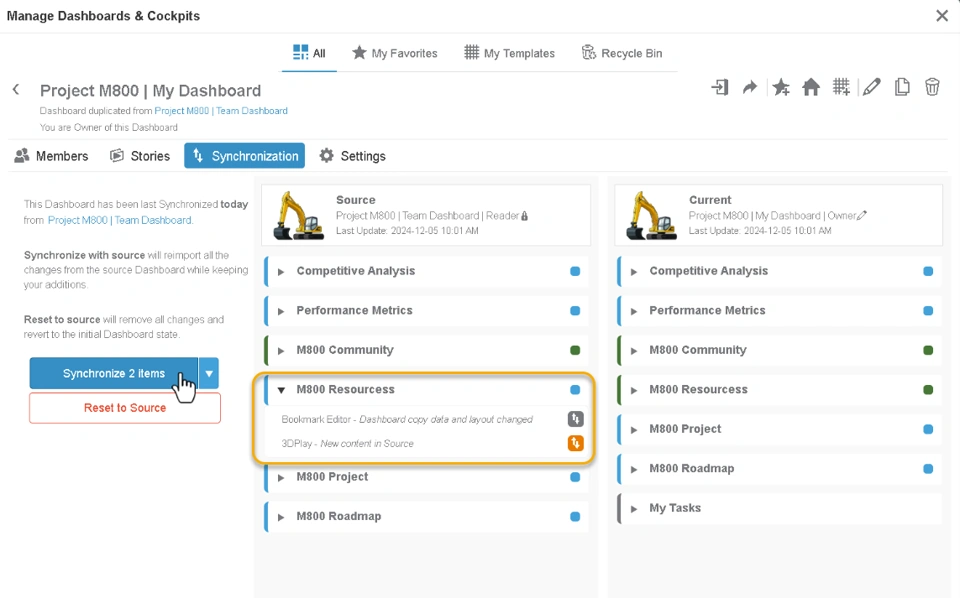

When these options are selected, members who have duplicated the dashboard will get access to a new tab "Synchronization". This tab displays the last synchronization status and allows you to perform synchronization on demand through the following two options:
  • Synchronize with Source: You can refer to the comparison view and synch specific tab or widget from the source dashboard.
  • Reset to Source: Remove all the changes and reverts duplicated dashboard to the initial Dashboard state.
The following image illustrates how you can synchronize changes done in the original dashboard:
Refer to the following video, which explains how team members can leverage the synchronization feature to synchronize their duplicated dashboard with the source dashboard:
