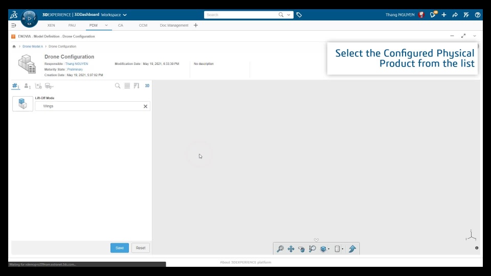

In R2021x FD06, users can now see the 3D of the Configured Product Structure as selections are made in the Product Configuration. This is assuming that the Configured Product Structure has 3D and the variants/options to be selected in the Product Configuration are used as effectivity in the Configured Product Structure. This enhancement provides the user with the immediate visibility outcome of his Product Configuration so that he can see what the Product Configuration will resolve to in 3D. See the attached video for quick demonstration.
