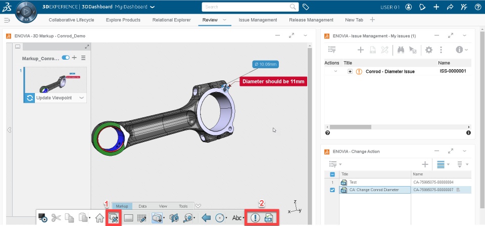

Let's look at a useful functionality during a Product Review that allows users to generate Issues and Change Actions directly from 3D Markup​​​​​​​:
After creating a Markup from the Markup section of the action bar, users can generate a new Issue or Change Action. By default, the Markup title and description are used as a title and description for the Issue or Change Action, but the user can redefine them as required. By default, the Issue or Change Action are attached to the Markup.
