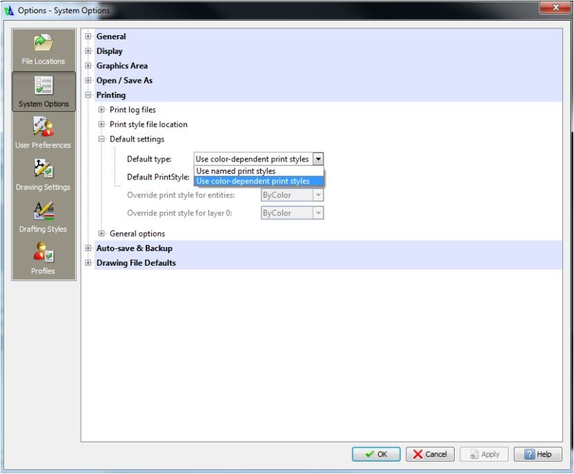

To select print style for current drawing go to, Tools>Options>System Options>Printing>Default settings and change the Default type to desired style.
You need to restart DraftSight for changes to take place.

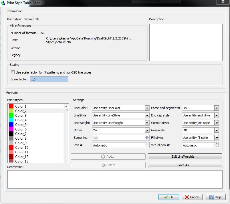

For Color Dependent t Print Styles:
Color-based printstyle tables map pen colors and lineweights to entities based on the color of the entities.
To edit the default settings, select one or more colors in the Print Styles list, then make changes to one of the settings on the right hand side. Refer below image, right hand side shows the settings assigned to print style. The LineColor determines the color that the object will print to.
For color plots, select "Use Entity LineColor". For black and white drawings, select black. Change the screening number if you wish to apply shading.100 determines no screening. To edit default lineweight values click on ‘Edit LineWeights’. Unit system can also be changed from Format LineWeights Dialog box.

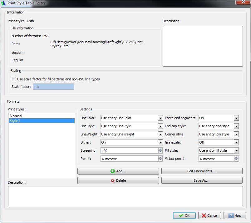

For Named Print Styles:
Named print style tables map pen colors and lineweights to entities based on a specific printstyle that is assigned to the entity.
This style contains the same printing properties as a color based print style (pen color, lineweight, screening, etc.), however the color of the entity does not control the printing properties at all. To change entity’s appearance after print, change its style instead of its color.
Hence you will see names of printstyles instead of colors in left pane of Print Style table editor. If you are creating new style by default it will take name Style#, you can rename it using ‘Rename style’ option. Select print style from left pane and make desired changes.

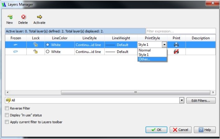

Since print styles are an entity propertes, it can also be assigned to layers.
To assign the print style to layer, go to Layer Property Manager >PrintStyle and select print style from drop down.
