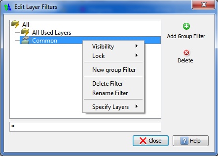

1. In the Layers Manager dialog box, click on Edit Filters.
2. By default we have a group named All and sub group called All used layers.
3. Click on Add Group Filter.
4. Provide a name fro this new filter and then close the dialog box.

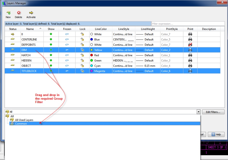

5. Now to add layers to this group, select the required layer (use Shift key and Ctrl key for multiple selection)

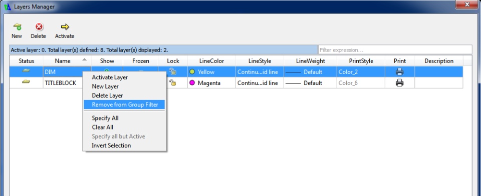

In order to remove a particular layer form the Group Filter:
1. Activate the Group filter in Layers Manager.
2. Select the layer to be removed.
3. Right-click and select Remove from Group Filter.

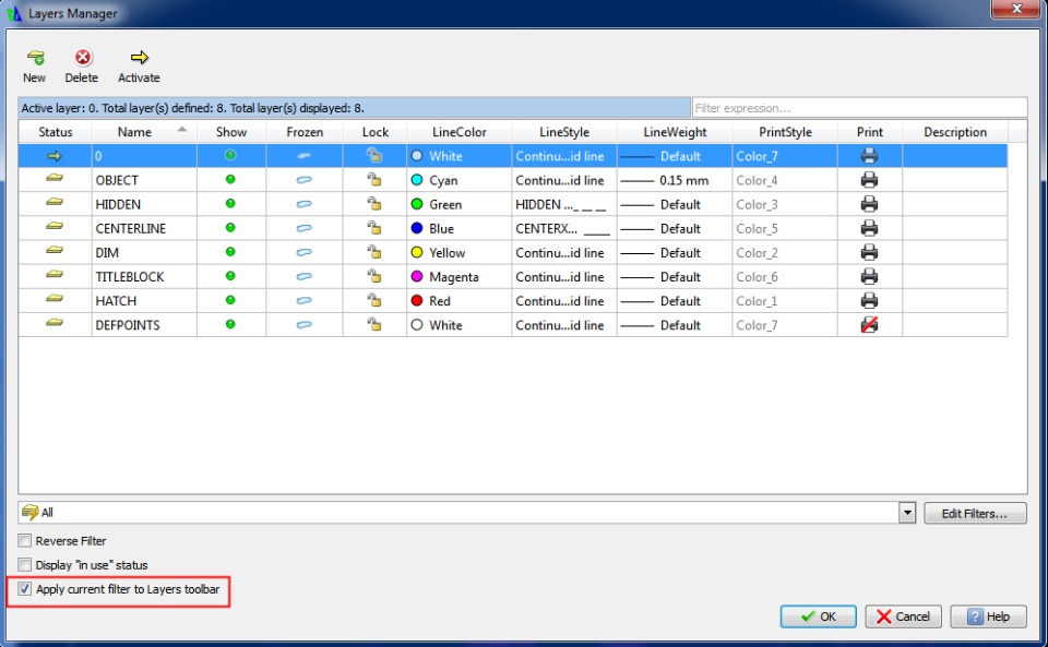

In order to see only Group Filter in the Layer Toolbar, check the option 'Apply current filter to Layers Toolbar'
Changing the Filter Layers properties:
The Layer properties such as Visibility (Show, hide, Thawed, Freeze), Lock of Layers in a filter can be quickly changed as:
1. Click on Edit Filter.
2. Select the Group Filter.
3. Right click and check for the options.
