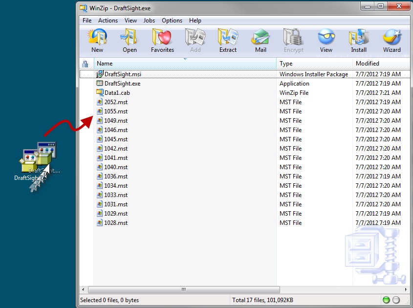

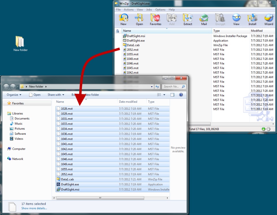

- Open your data compression utility software. Drag-and-drop the DraftSight.exe file into your data compression utility software. This will allow you to extract the contents of the .exe packaged file.
- Create a new folder on your machine and extract the contents of DraftSight.exe into this folder

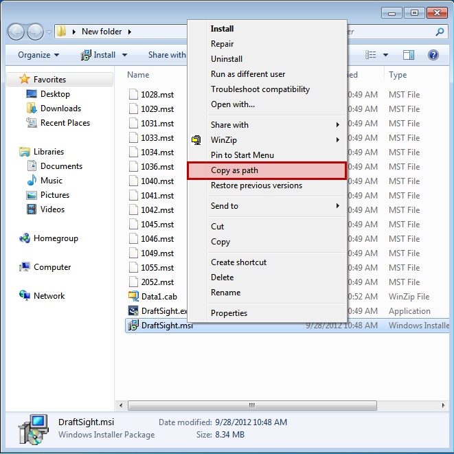

- While holding the Shift key, right-mouse click on DraftSight.msi and select, Copy as path as shown below:

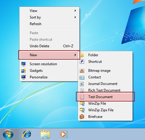

- Create a new text document on your desktop by right-mouse clicking on your desktop and selecting New > Text Document as shown below:

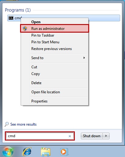

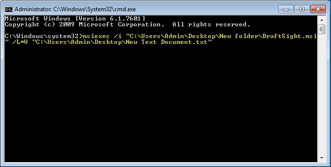

- Now click on the Windows Start menu icon and search for cmd.exe
- Right-mouse click on cmd.exe and select Run as administrator
- The command line will be written in the following form:
msiexec /i/L*V
therefore, first add the following line:

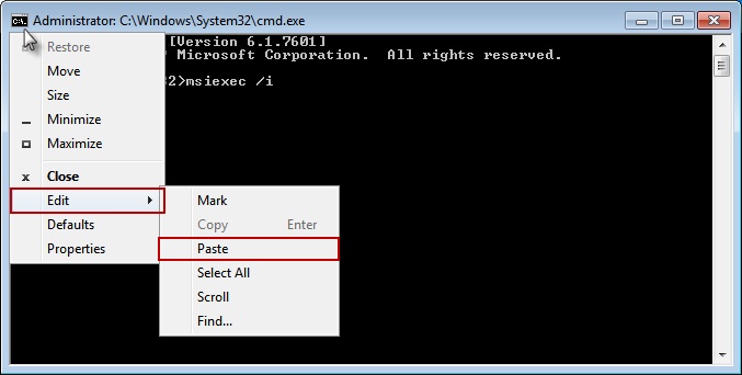

msiexec /i
then go to the Edit menu and paste the path to the installation directory as shown below:

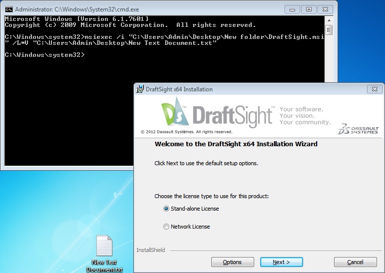

Now add the following to the command line:
/L*V
Finally, add the path to the text file created on your desktop. Use the "Copy as path" shortcut explained in step 3 to copy and paste the path into the command prompt.
The completed command line should look similar to this with maybe the exception of the path names:
- When done hit the Enter key to initiate the installation.
- Continue installing DraftSight...

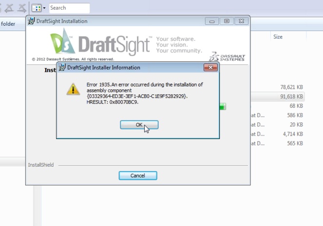

- If prompted with an error message, proceed with the unsuccessful installation until the installation dialog box is completely closed.
Note: logging will not be finalized until all installation dialog boxes are closed - Verify whether logging has been completed by opening the text document created.
- The log should contain a lot of information. Using Ctrl+F to initiate the find tool will allow you to search for the term Return value 3 which will point to the section where the installation failed.
- Reviewing the contents of the log immediately before the Return value 3 string will help determine which action failed.
