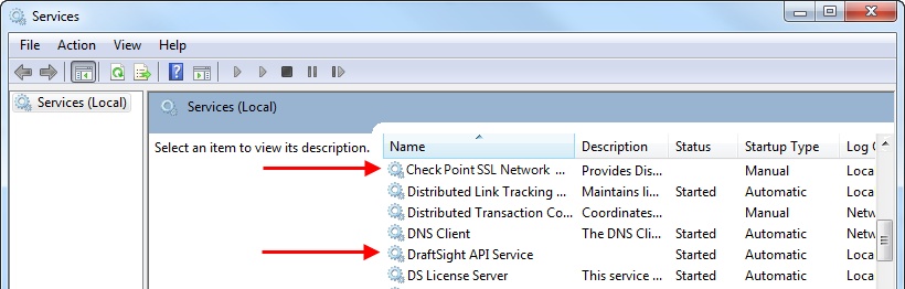

1. On Windows 7 or Vista, enter Services in the Start menu. On Windows XP, click on Start, Control Panel, Administrative Tools, and Services.
2. You should see the DraftSight API Service; in addition look for “Check Point SSL Network Extender”.
3. Right-click on the “Check Point SSL Network Extender” service and select Stop.
4. Install DraftSight.
5. After installing DraftSight, go back to the Services window, stop the Draftsight API service and re-start the “Check Point SSL Network Extender” service (right-click on it and select Start).

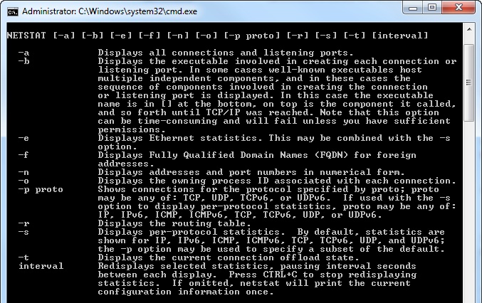

The command “netstat” displays protocol statistics and current TCP/IP network connections.
Several options are possible:

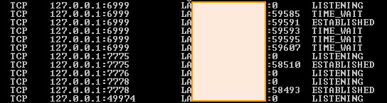

netstat –a will display all connections and listening ports. Look for port 7776:

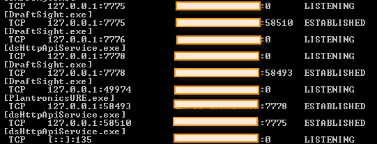

netstat –a  –b will display all connections and listening ports with the executable involved in creating the connection:
This would be useful to identify the application using the desired port.
