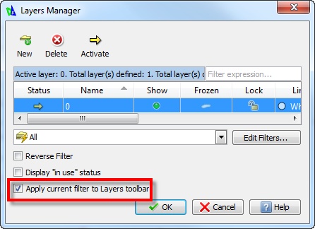

Cause
Users had enabled the options “Apply current filter to Layers toolbars” in the Layers Manager the last time they used DraftSight.
Solution

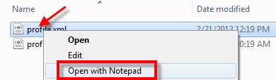

1. Locate the profile.xml file in:
  • For Windows 7/8/Vista: C:\\Users\\User_name\\AppData\\Roaming\\DraftSight\\1.2.26X\\Profiles\\__unnamed profile__
  • For Windows XP: C:\\Document and Settings\\User_Name\\Application Data\\DraftSight\\1.2.265\\Profiles\\__unnamed profile__
The folder 1.2.265 refers to V1R3.1, it would be 1.2.263 for V1R3
2. Right mouse click on it and select Open with Notepad.

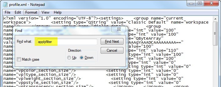

3. Then search for the variable responsible for this setting by pressing simultaneously the Ctrl and the F keys on your keyboard.
4. On the Find dialog box enter “applyfilter” in the ‘Find what’ field. Click on Find Next to launch the search.
5. Look for the result showed in the screenshot below and when you find it close the Find dialog box:
It shows:
6. Change the value from “1” to “0”.
Note: if the variable was set on 0 already, obviously the root cause would be different.
7. Save the profile file and close Notepad.
DraftSight will now start.
