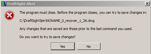

Probably the most dreaded thing by any user, is when in the middle of that job (which deadline is finishing), the computer or application “freezes” and or crashes. Or you just updated your software, and what was working perfectly, all of a sudden, doesn’t work anymore. Regardless of the applications used, if it didn’t happen yet, one day it will.

How to fix it – A DraftSight scenario
As there are multiple possible causes to look at, the priority is to reduce the number of possible culprits. And there is no better way than start with the basics. If your machine is based on a network environment, contact your IT Department/LAN Manager concerning the problem. We recommend that the following troubleshooting steps are performed under the Administrator account (not User account, even if with extended permissions).
