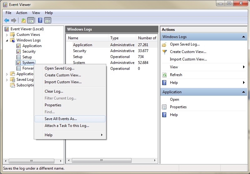

System log:
Start/ Run
Type ‘eventvwr’ (without quotes) and press enter.
Expand 'Windows Logs'.
Right click on ‘System’ and choose ‘Save All Events As...’
