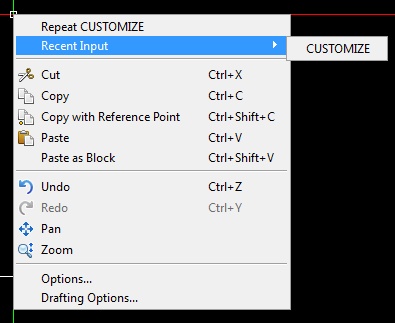

By default, when you click the right button of your mouse, you see something like this
Unless you are happy with these options, there is no reason why you shouldn’t make some changes, and for instance add to the menu commands you use regularly, or more often at a given stage of your project.

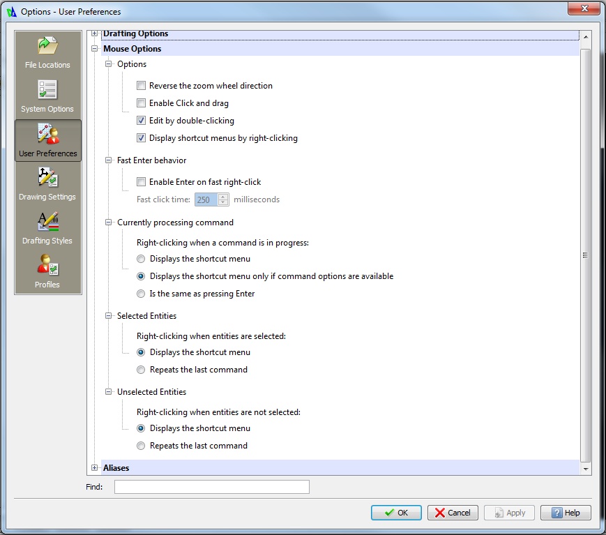

Mouse Options can be found under Options> User Preferences> Mouse Options
But further customization can be achieved:

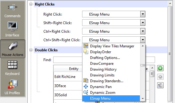

-              To define actions for right-clicks:
1-  Click Tools > Customize Interface (or type Customize).
2-  In the Customize dialog box, click Mouse Actions.
3-  Expand Right Clicks.
4-  For Right Click, Shift+Right Click, Ctrl+Right Click, and Ctrl+Shift+Right Click select a menu, command, command sequence, or option to be issued.

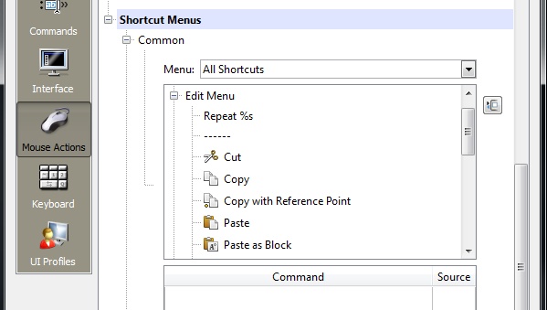

-              To manage shortcut menus:
3-  Expand Shortcut Menus > Common or Contextual.
4-  In Menu, or in the list of shortcut menus, select a shortcut menu. You can edit common shortcut menus:
The Default Menu displays if you right-click when no command is active.
The Edit Menu displays if you right-click when drawing entities are selected.
The Command Menu displays if you right-click when a command is active and no shortcut menu is defined for that command.
The contextual menus display if you right-click when a specific command is active.
5-  To insert a command or option in a shortcut menu:
Click Show command explorer.
Under Command Explorer, select an item and drag it to a menu or toolbar.
6-  To replace a command or option, select an item in a shortcut menu, then select another command or option in command.
7-  To remove a command from a shortcut menu, select an item in a shortcut menu and click remove (the option is available for contextual shortcut menus only).
