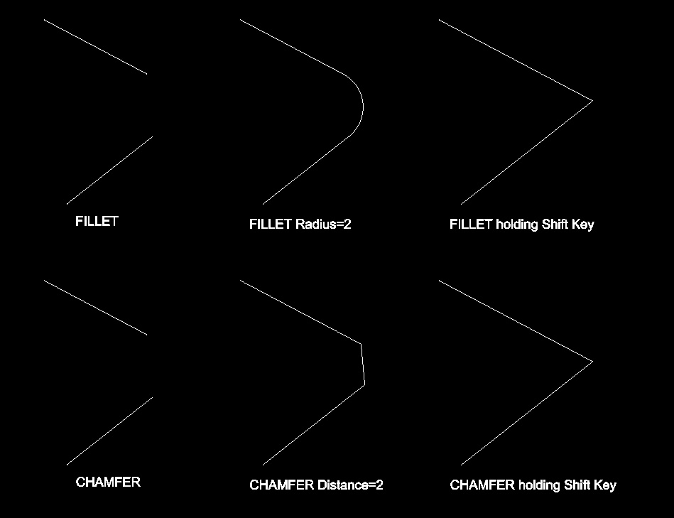

As you can see, using the Shift Key overrides the default value of the command. This process is also valid for the Chamfer command. You can apply an acute corner by pressing Shift and specifying the second drawing entity. This method creates acute corners without changing the chamfer distances to join two end points.
See the image below showing the results of using the Shift Key in both commands, and for comparison, the results without using the Shift Key.
Fillet/Chamfer + Shift Key Demo
