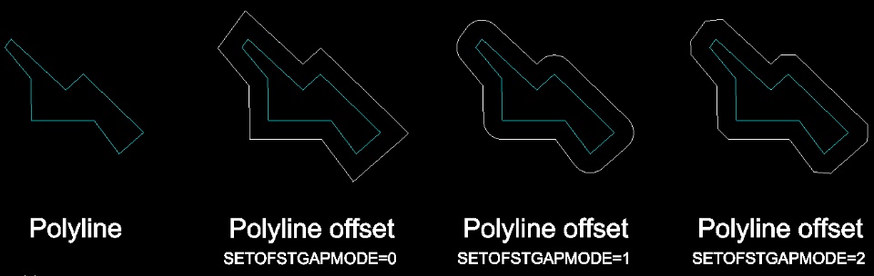

There is other variable “attached to this command, that can also be very helpful, and that is SETOFSTGAPMODE.
SETOFSTGAPMODE Controls how potential gaps between segments are treated when closed polylines are offset. For value:
-          0 - Fills the gaps by extending the polyline segments
-          1 - Fills the gaps with filleted arc segments (the radius of each arc segment is equal to the offset distance)
-          2 - Fills the gaps with chamfered line segments (the perpendicular distance to each chamfer is equal to the offset distance).
Intrigued? See below an example of a polyline offset, with the different values of SETOFSTGAPMODE:
As you can see from the results, this is a good example of what you can achieve by changing a single value of a variable, and that avoids having to perform several operations/commands, in order to obtain the same results.
