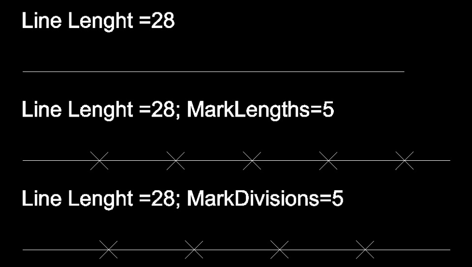

If you’re still confused about the difference between them, here’s an example:
As you can see, MarkDivisions divides the entity selected in equal parts, being the value you provide, the number of parts you want the entity to be divided in. On the MarkLengths case, the number you provide corresponds to the distance between divisions, what usually results in one of the segments/divisions being smaller/larger at the end ( in the example above, 5 segments are 5units apart from each other, but the distance from the last point to the end of the entity/line is 3 units.

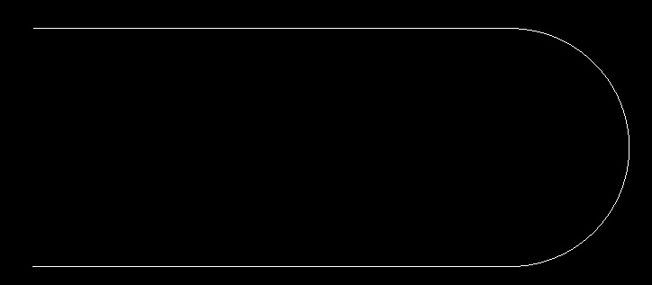

We will start with a Polyline

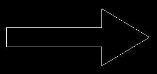

And this is the Block called “arrowBlock”, that was created earlier

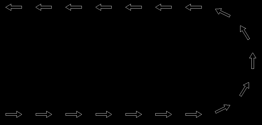

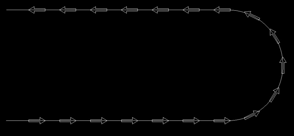

- So in the end, I obtain something like this:
And deleting the Polyline I used as construction line,

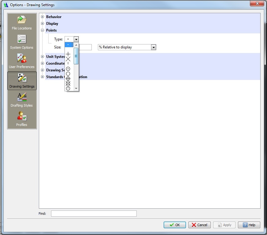

- The Points generated by the commands, might have a different appearance from the ones shown above. In some configurations might seem that the command has failed, as apparently the points were not created. In these cases, If you use a cross selection window with your mouse over the area where the points should be, you’ll see that they will be selected /highlighted. To make them more “visible” at first glance, you might want to change their appearance. You can use the Command Variable POINTFORMAT
- Type POINTFORMAT in your command line, and hit Enter
or
- In the DraftSight Menu, Go to Tools> Options.
- Click the Drawing Settings Tab, and Expand the Points node.
- Select the Type of Point (appearance), and the size of the point (% relative to display)
