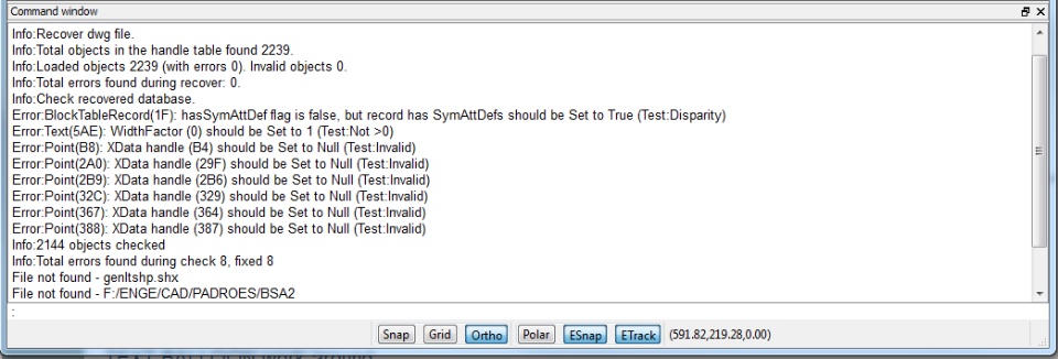

The Recover option on Open, scans/checks the file for errors, and fixes them while opens them. Once the file is open, in the command line you can see the results of the recovery process as shown below:
You can use this information to help you identify the cause of the errors, and address them.

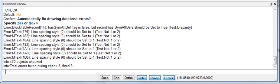

If a file starts to present wrong results and/or unexpected behaviours, there’s a command you can use to identify underlying errors: the command _CHECK .
The command _CHECK searches the drawings for errors and on your input, can automatically fix them. Here’s an example of a result:
The summary of the command can also give you clues on what might be causing the problems (e.g. in this case, Attributes of a Block, and Multiline Text Properties). This information allows you to, if not identify the cause of the issues, at least narrow the possible causes, and replace them or re-create them.
