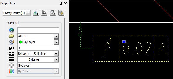

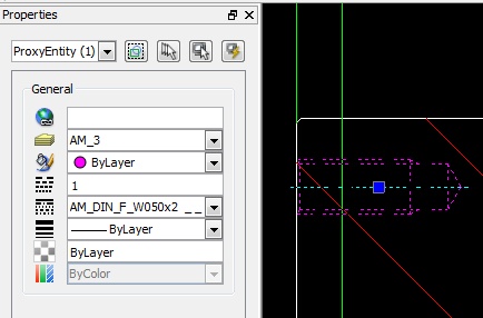

If you select the problematic entities, verify in the Properties Palette if indeed they are
Proxy Entities (examples below):
or
