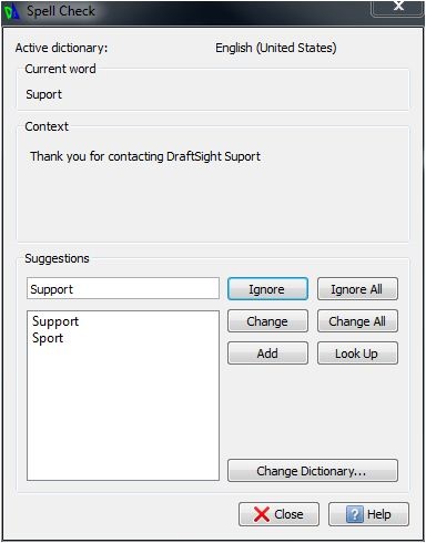

This command can be accessed by typing command SpellCheck at command line. For next command prompt DraftSight will prompt to select entities. You can select text or specify All to check spelling in entire drawing.
If you select text entities for spell checking; spelling is checked only in entities in the current selection set. Whereas if you enter the All option for select entities, spelling is checked in all text entities in model space and in all sheets. However not in block definitions of unselected block references or in text within dimensions.After specifying entities, Spell Check dialog box will open to show you the results. If a misspelled word is identified, the word is displayed in dialog box. You can accept the suggestion provided by DraftSight or can ignore.

 Adding words to spelling dictionaries:
If you want to add specific word to custom dictionary you can use Add button in Spell Check dialog box. The word will be added to the current custom dictionary.
