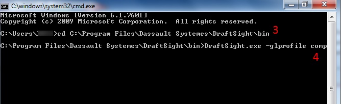

FOR CASES WHERE DraftSight CRASHES ON STARTUP

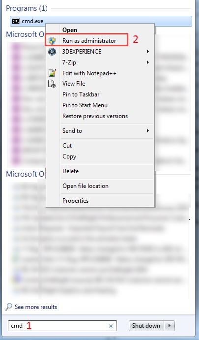

OpenGLProfile can be set to compatible on startup from the windows command prompt.
1) From the Windows start menu, search for cmd.exe.
2) Right click on cmd.exe > Select 'Run as Administrator'
3) Change the directory to DraftSight installation folder. Usually it is "C:\\Program Files\\Dassault Systemes\\DraftSight\\bin ".
CD C:\\Program Files\\Dassault Systemes\\DraftSight\\bin
4) After the directory changes to above, pass the following argument : DraftSight.exe -glprofile comp
