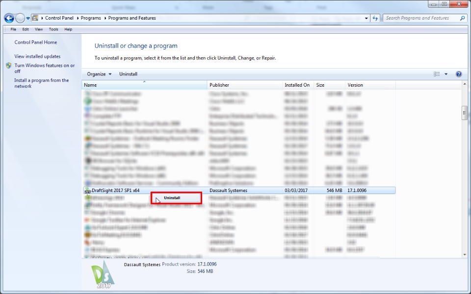

- Login as administrator (Not as a user having administrative privileges!)
- Go to Windows Control Panel > Programs and Features . Right Click on DraftSight 2017 SP1 X64 and select Uninstall as shown below:

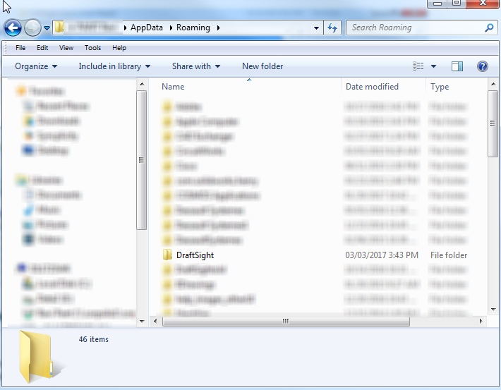

C:\\Users\\\\AppData\\Roaming\\DraftSight (to ex. DraftSight_OLD)

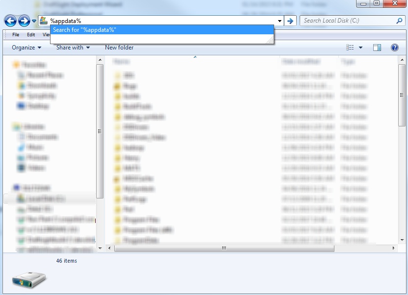

Note: AppData might be hidden and not show in Windows Explorer. The easiest way to get to that folder location is by typing %Appdata% in the Windows Explorer Address Bar and pressing enter.
You will see the DraftSight folder

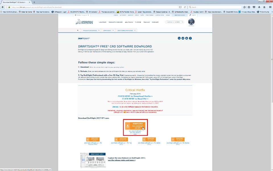

5. Go to https://www.3ds.com/products-services/draftsight-cad-software/free-download/ and download the installation file for DraftSight 2017 SP1 X64 as shown below:
6. Run the installation from the downloaded folder by double clicking DraftSight64.exe.
7. After the installation run DraftSight 2017 SP1
