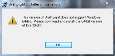

In case, you start installing 32 bit version of Draftsight on 64 bit system you will receive the following error:
Similarly, in case you start installing 64 bit version of DraftSight on 32 bit system, you will receive the following error:
In order to avoid the above errors, please download and install the correct installable.
