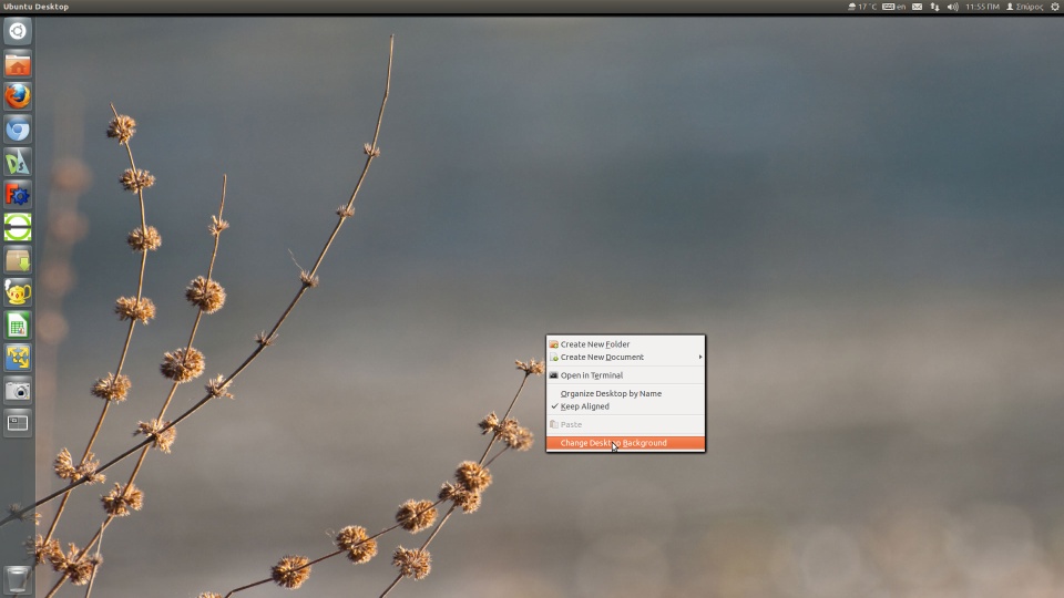

  • Change your theme to one of the defaults  Ubuntu themes (Ambiance or Radiance). These themes are known to work properly with DraftSight.
Right click on the desktop and select "Change Desktop Background" then on the Appearance window you can select as "Theme" Ambiance or Radiance.  The new theme will be applied in all  applications.

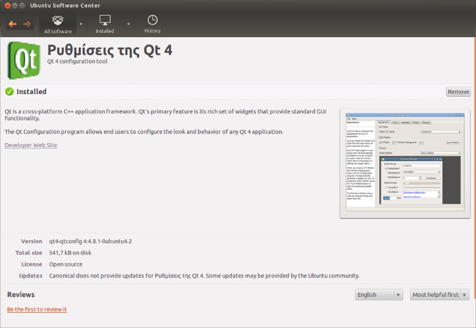

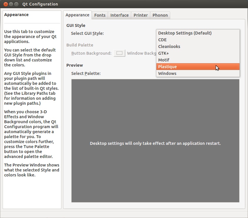

  • Install qt4-qtconfig package and select as GUI style the Plastique theme.

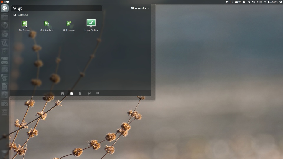

This is a little application that  manages the appearance and the behavior of all the Qt-based applications. It is not installed by default so it's necessary to install it via Ubuntu Software Center, Synaptic or any other package manager. After the installation, you can find this application on the Dash as "Qt Settings". Change the GUI style from "Desktop Default" to "Plastique" and save the changes. This change affects all the Qt-based applications.

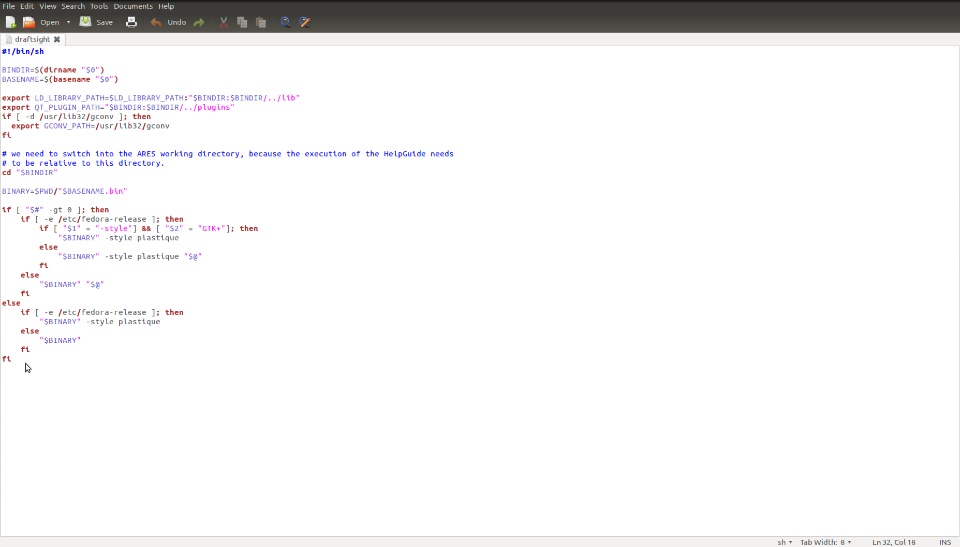

  • Edit Manually the DraftSight's startup script.
This workaround will change the appearance of DraftSight only. But it's not recommended for non-experienced users for two reasons:
  1. The startup script is a very important piece of DraftSight's installation. Any mistakes while editing this file may cause a damaged installation.
  2. The changes are not permanent. All the changes will be lost after an upgrade or re-installation of DraftSight.
You have to open DraftSight's startup script with gedit as root user in order to make changes on it. To do this open a terminal and type the command:
sudo gedit /opt/dassault-systemes/draftsight/bin/draftsight
Then on line 32 add the " -style plastique " parameter.  Save the file and close gedit.
