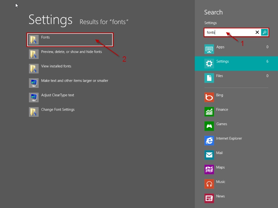

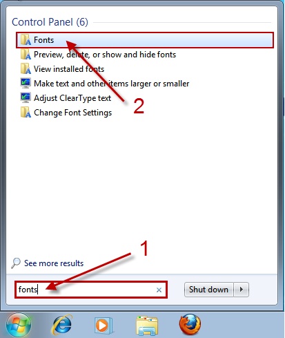

    For Windows Vista, 7, or 8:
     i.  Click the Windows start logo in Windows Vista and 7 or bring up the Start Screen in Windows 8.
    ii.  Type fonts into the search box, then press the Enter key. See the figures below:

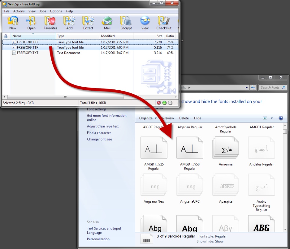

  3. Open the downloaded compressed file containing the fonts.
  4. To install the fonts, drag and drop the FRE3OF9X.TTF and FREE3OF9.TTF fonts from the zip file into the fonts directory as shown in the figure below:
    Note that the FRE3OF9X.TTF is the extended version of the Code 39 format which includes all ASCII characters.

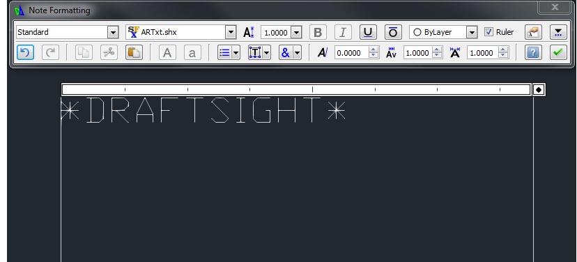

  6. To create a barcode, type NOTE in the command line followed by hitting the Enter key.
  7. Specify your corners of the note box.
  8. After the Note Formatting toolbar appears, proceed to type in the values of the barcode using regular font.  This will allow you to see what you are typing prior to changing the font.
    Note:  It is very important that you start and end a Code 39 barcode with an asterisk as shown below.

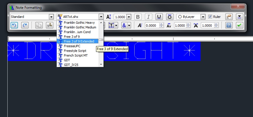

  9. Now highlight the text then click the drop-down menu to change the font to "Free 3 of 9" or "Free 3 of 9 Extended" as shown below:
  10. Modify the rest of the note properties and when complete, click the green checkmark button.  Your barcode should now be complete.

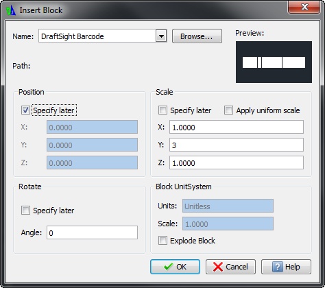

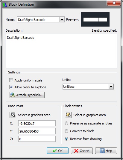

  12. At the same time, should you need to increase the vertical scale of the barcode, you must first convert the barcode to a block.  Use the MAKEBLOCK command to convert the barcode text to a block.
  13. Use the INSERTBLOCK command to insert the barcode.  Change the value of the vertical scale to your needs.  When done, click OK to insert the block into your drawing.  The example below was created using a Y: scale of 3.
