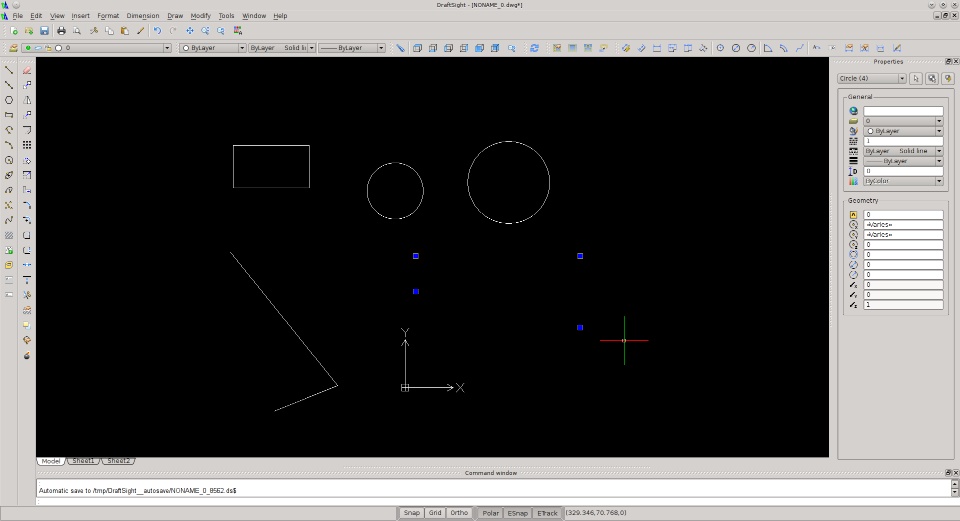

Sometimes,  you may see some unselectable "dots" on your drawings.

These entities are actually zero-radius circles that have been created due to bad behavior of your E-snap settings. The problem has been reported to DraftSight's technical team and it will be fixed in a future release of DraftSight.
An example drawing that contains some unwanted zero-radius circles.

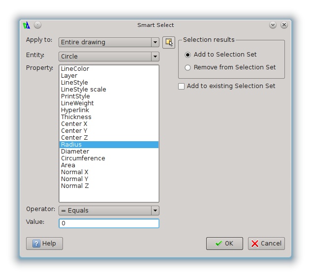

You have to use the Smart Select command which is accessible from your Properties Bar. Make sure that no other entities are selected in your drawing before running this command.
After that, you have to apply the following settings in the command's dialog box.
Apply to: Entire drawing
Entity: Circle
Property: Radius or Diameter
Operator: = Equals
Value: 0
Selection results : Add to Selection Set
And press OK
Smart Select dialog box
You will see that all your unwanted "dots" are now selected.
Just press Delete in order to delete them. Now your drawing doesn't contain any unwanted entities.
