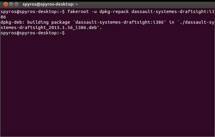

Open a terminal and type the command:
fakeroot -u dpkg-repack dassault-systemes-draftsight
or if you have successfully installed DraftSight on a 64bit system:
fakeroot -u dpkg-repack dassault-systemes-draftsight:i386
and wait until the command finish the creation of the backup installer.

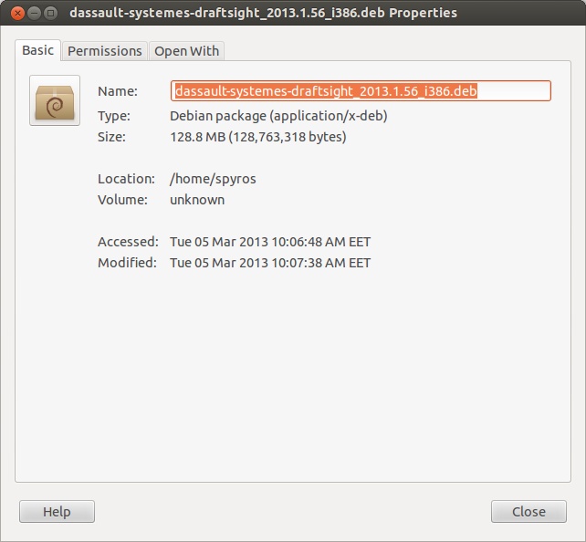

After that you can find a .deb installer inside your home folder named dassault-systemes-draftsight_version_number.deb
So now you can install the newer version of DraftSight without worries. If you are not satisfied from the newer version simply right click on the backup installer and select the option "Open with GDebi Package Installer" to re-install the previous version of DraftSight. But before you go back to the previous version make sure that you reported any possible problems of the newer version to the Development team, in order to help the further improvement of DraftSight !
