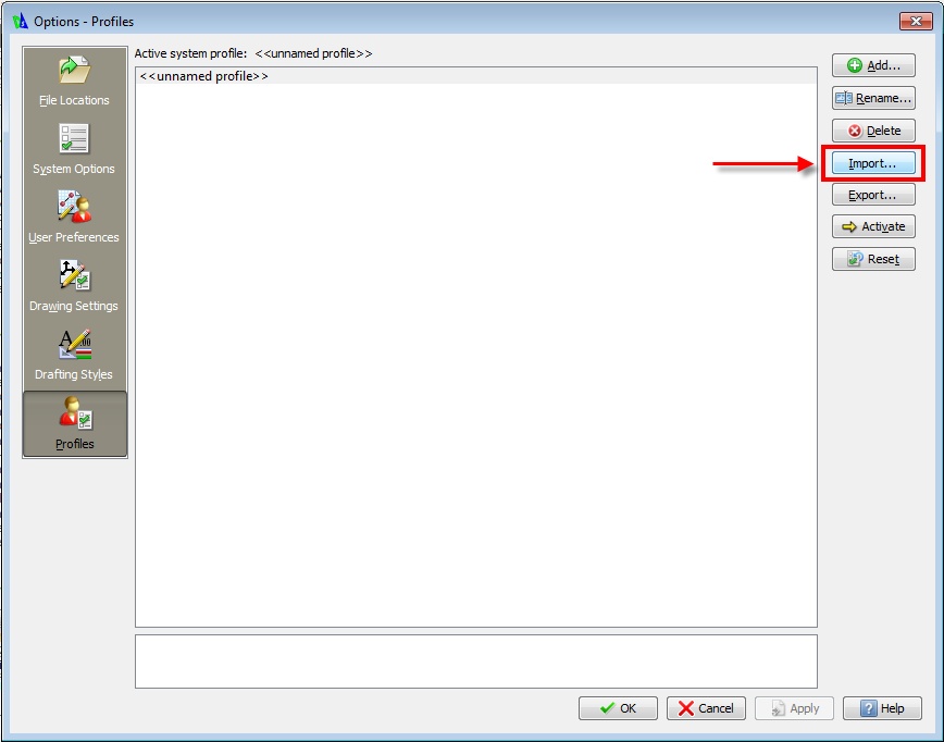

1.  Type PROFILES in the command line and hit Enter.
-OR-
      Go to:  Tools > Options > Profiles
2.   Click the Import… button, as shown below, to activate the Import Profile window.
The Import profile window allows you to browse and import other profiles you may have created (2).  In the following instructions, we will navigate and import the default profile used in the previous version of DraftSight, V1R1.4.

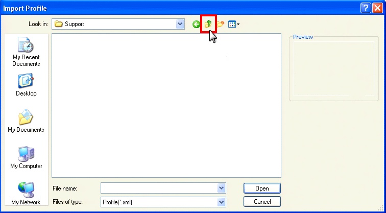

For Windows XP / 2000, in the Import Profile window, click the back button, as shown below, to navigate back one directory.

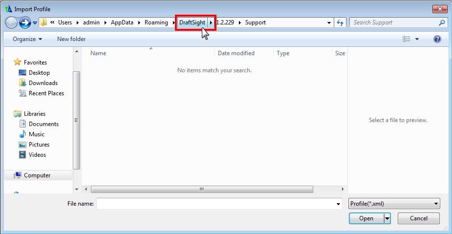

For Windows 7 / Vista, in the Import Profile window, click on the word DraftSight in the address bar, as shown below, to navigate back one directory.
The folder which contains the settings for V1R1.4 is named, 1.2.205, and the folder which contains the settings for V1R2.0 is named, 1.2.229 (3).

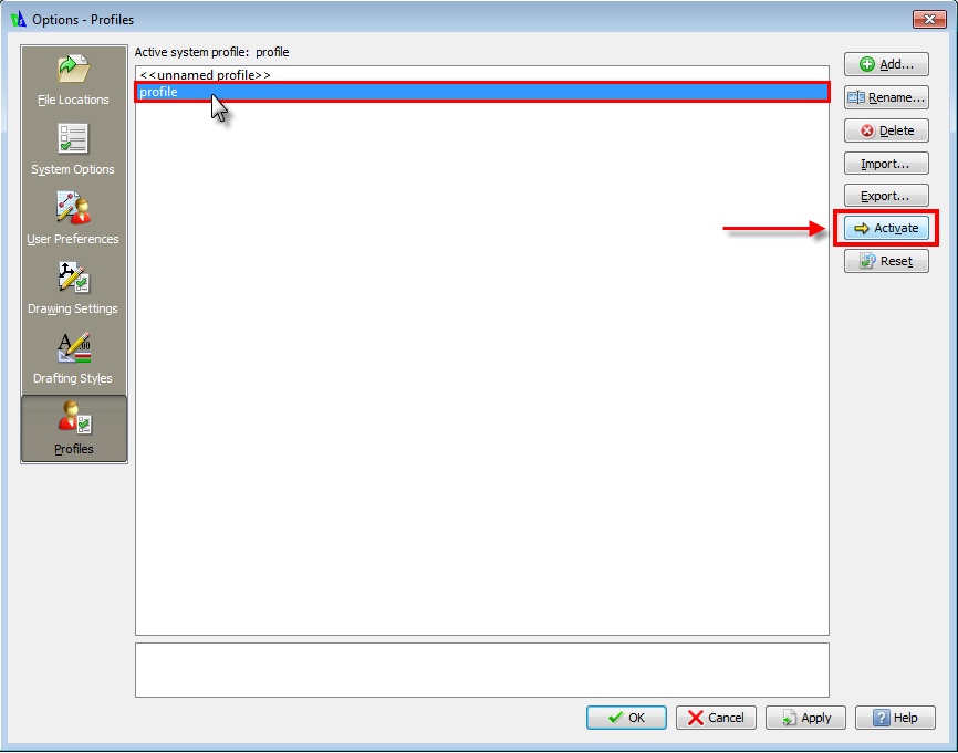

6.  When the Import Profile window appears, give the imported profile a name and description, if you wish.  Then click OK.
7.  In the Options-Profiles dialog box, select the imported profile from the list,  and then click on the Activate button on the right, as shown below.
8.  Click OK.
Your previous settings and customizations should now be carried over and active in the new release.
